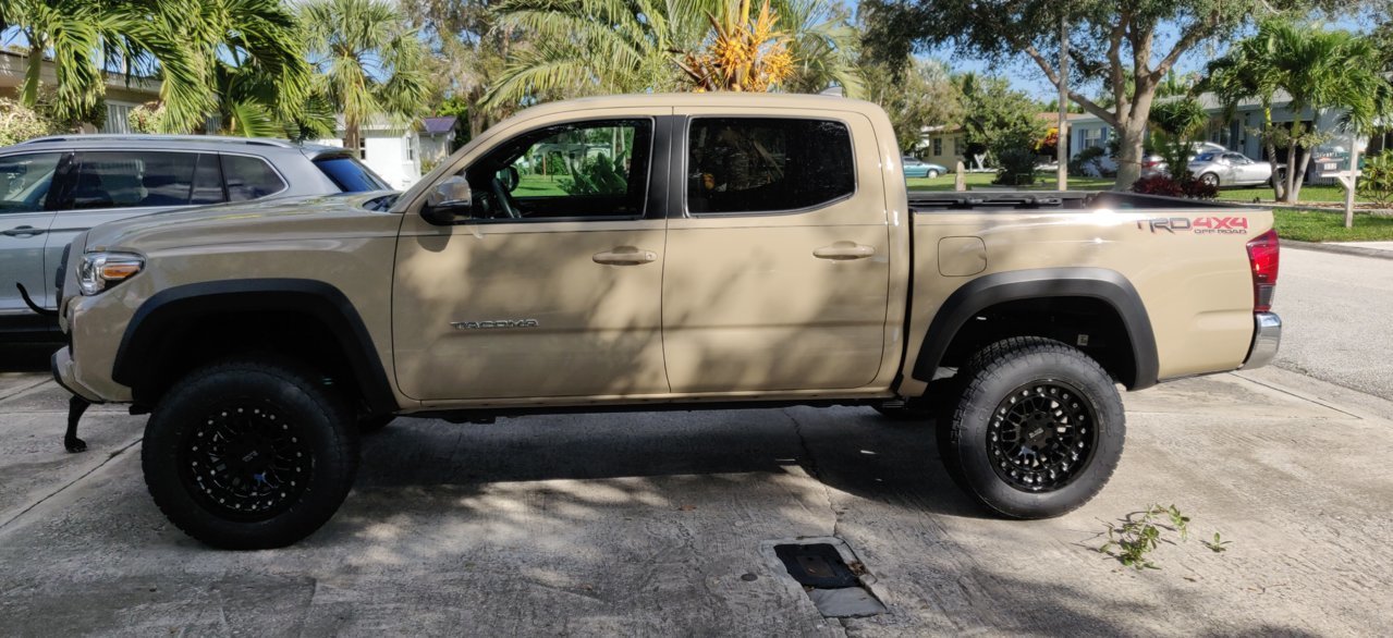

    19 OR, debating on these Black Rhino 18's, I liked the Toyota OEM factory 16" Rim and debating going back and selling this setup. OME Medium lift, rides nice as is but the extra tire weight is indeed noticeable. IMG_20191020_160219.jpg

    Let me know if you decide to part with them. I like the look.
