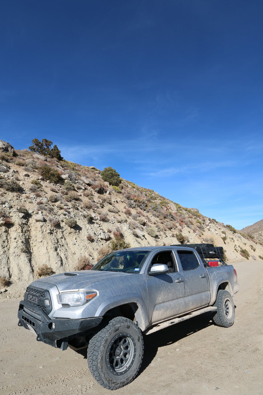

  16. Feb 2, 2018 at 8:05 AM
    #156
    TexasTacoma713
    TexasTacoma713 Well-Known Member
    Oct 19, 2015
    #167065
    1,716
    PNW
    2024 OR

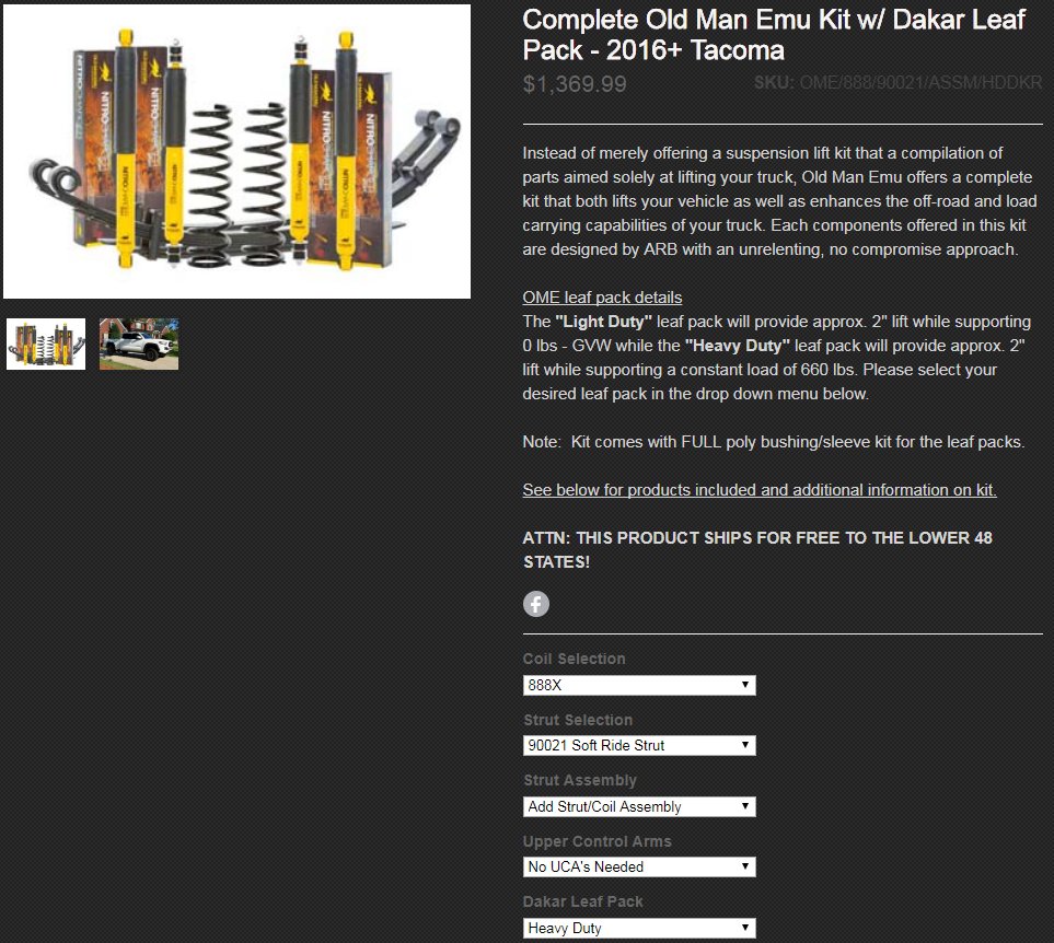

  17. Feb 2, 2018 at 8:41 AM
    #157
    RobP62
    RobP62 NVR20LD
    Jun 4, 2017
    #220718
    41,519
    Rob
    Street, Md.
    TTC Member #0125
    Very nice truck Man! Love the front bumper!
    Yea, I think it just depends on what camp you are in. Either OME or Bilstein. I really doubt for my needs either is a bad choice. I just happen to know what the guy I intend to ask to help me install my kit is running on his truck, and I like what @blaineehughes and I talked about how our trucks, driving habits and terrain are so much alike and how satisfied he is with his kit.
    I feel like this kit below is perfect for me and I would only go with the heavy duty leaf pack so that when I load the bed up or tow I am covered. If I can do that without the heavier leafs then so be it.
    I want to have a more on-road soft ride system capable of handling pot holes and rr tracks at higher speeds. I also need it to eventually handle anything I might throw at it off road, which for me would never be anything really hard core or require a long travel kit. The price of this kit is $300 less than the one you posted, but that's because with the OME kit, no UCA's are needed. I believe aftermarket UCAs are needed with the Bilstein kit, no? And I have searched and found that I can save another $250 bucks buying the same kit in parts from various sources so the total would be closer to $1,100 bucks. Which is then $500 less than the Bilstein kit. Since the two systems are so similar the savings can be used to help purchase some body armor.
    Of course, as I've stated, I am so new to this and just learning. Heck I am no where near ready for this at all. I just want to be sure that if I decide tomorrow to do this, I am not scratching my head wondering what to do. I want to be 100% ready when the time comes.
    Rob
    blaineehughes likes this.
  18. Feb 2, 2018 at 10:07 AM
    #158
    TexasTacoma713
    Oct 19, 2015
    #167065
    1,716
    PNW
    2024 OR
    Get the UCAs
    Ok4WD had a Black Friday sale for that OME kit and it came with free LR UCAs
    Oh and I fly over train tracks and speed bumps like butter with the blistens
    Hellapeno and RobP62 like this.
