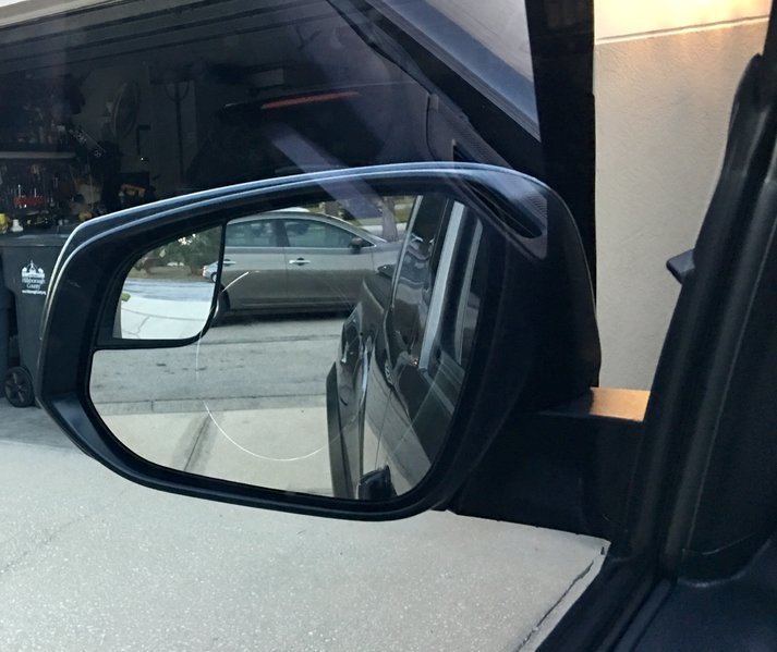

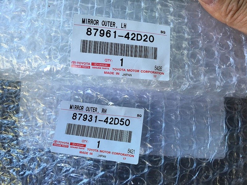

    I thought we can start a discussion about the RAV mirror swap instead of crowding the other thread.
    Here are the part numbers.
    @ChasVS can help out too

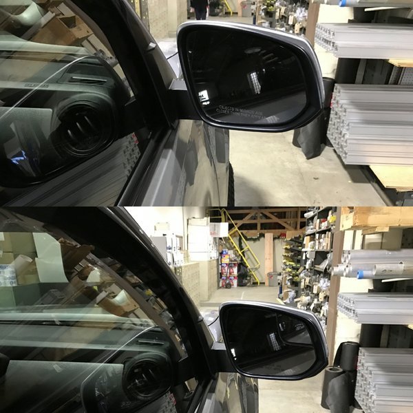

    That's awesome. I have stick on convex mirrors but these look clean. What's the install process and cost?

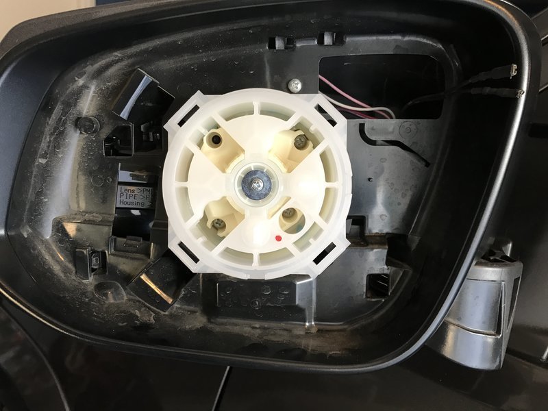

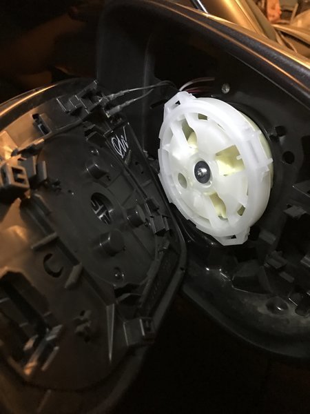

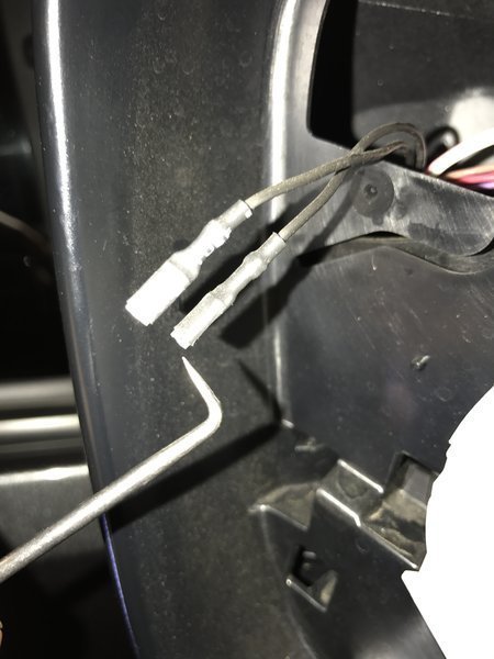

    These are the install instructions I followed as provided by @Siblue.
    Process took less than 15 minutes!
    Move the mirror housing forward to have a better working area.
    Pushed the glass up to show the two lower clips and pry the mirror from white base, same with the upper two clips.
    Remove the two heater wire pins
    Reinstall in reverse order.
    The two wires are not polarity specific since it's only a coil.

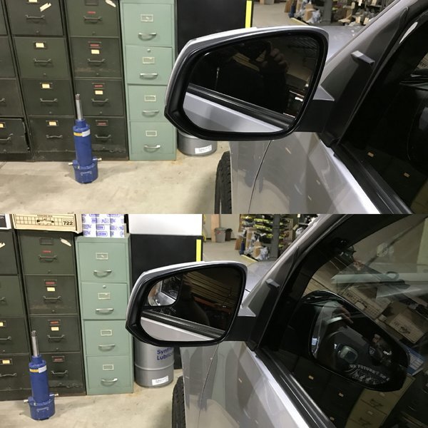

    2017 Tacoma ACLB TRD Off Road
    I did just the driver side. The passenger side is already a convex mirror so there's no blind spot. The little convex corner is too small to be of much use that far away from the driver. Just my experience and saves $50 or so.

    Sounds like with the Rav4 mirrors swapped in, they'll still be heated since the coil stays from the truck?
