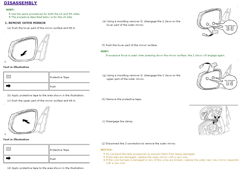

    I saw it somewhere but for the life of me I cannot find the best way to remove the mirror. Help please, on the way now to pick up my mirrors and hoping to install them soon

    It really is just a matter of yanking them off but it does seem sketchy in the moment. I think I actually removed the cover after a few attempts at just the mirror unsuccessful. If you installed MESO turn signals you’ll know how easy that cover pops off ( tie a plaster bag around the mirror to prevent flying off damaging) then from the back side you can kinda see where the clips are (I think 4) and I used a small flat head to kind of open the clip while pulling the mirror out with my other hand. After the first clip it’s easier and don’t forget there’s wires for the heated mirrors so don’t go yanking it too far out

    I got them off pretty easy, new ones went on perfect. These are a major improvement in seeing what's in the blind spots. Pretty happy on this mod.

    I did find it and changed them both out. Thank you for sharing it as others might need it.
