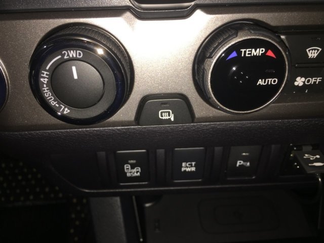

    You do have heated mirrors already. Standard even on the SR. It’s the button just below and left of your climate control knob.
