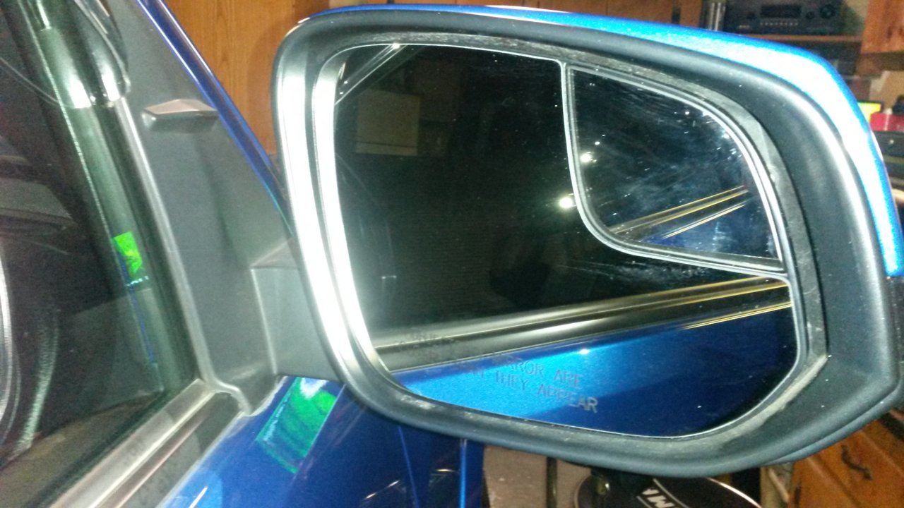

  19. Dec 29, 2017 at 6:53 PM
    #119
    mrproduxn
    mrproduxn Well-Known Member
    Feb 22, 2013
    #98175
    6,391
    steve
    Retired DoD SE VA
    Tacomas 1987,2000,2008, 2016,2012,2008
    Retired/Hobbyist old as f***
    I did my driver side a few days ago while doing the meso ultimate led turn signals. Sorry I did not do both. Awesome to see an extra lane next to me. Had a near miss on passenger side yesterday. Ordered that mirror.
