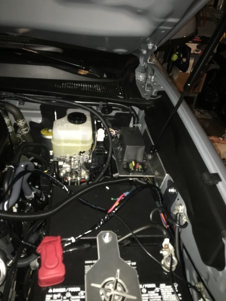

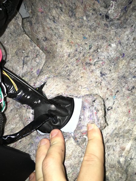

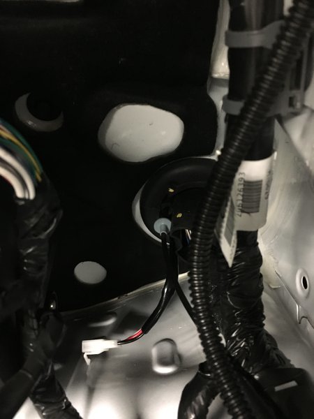

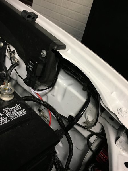

    I took some pics of how I ran the wire for the LED light bar and where I put the relay. I really dislike relays so in time as things begin to collect I may buy another relay/fuse box like the one in my Jeep.
    Relay and excess wire ziptied and tucked up into the fender.
    Single 1/2" cut with a razor and pushed the wire through
