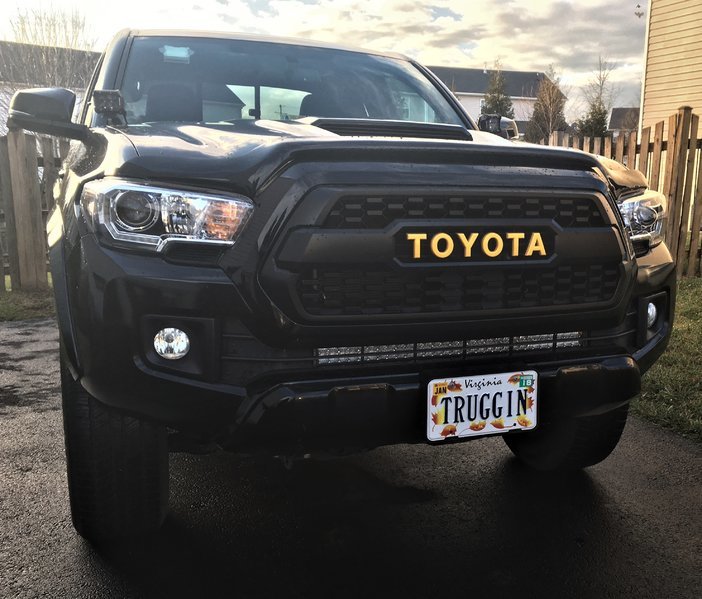

    Oh... I hadn't even considered where the winch mounts. The light bar is on top of the crash bar, so I'm not sure it wound impact the winch... Would it?

    The winch mounts about 1" behind the lower grille so the light bar would be out. You might be able to run one if it's a flush mount one but not behind the grille

    Thanks... But is it above the giant aluminum crash bar? The light bar sits directly on top of that bar.

    Yes, that's where the solenoid will sit.

    Check out my picture in 519, the hoop wont really bother the light bar. I am not sure about the space though for the winch
