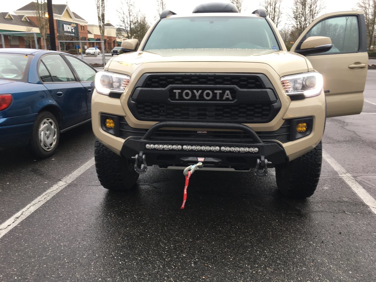

    Installed my custom SSO bumper last weekend using this tool (already owned it) https://www.amazon.com/Milwaukee-2426-20-Cordless-Multi-Tool-Tool/dp/B004M8R9VE/ref=sr_1_fkmr0_1?ie=UTF8&qid=1521577390&sr=8-1-fkmr0&keywords=MFR+#:+2426-20 and it worked great, no plastic flying everywhere. Easy control and nice straight lines since I deviated my cut line a bit from the instructions.
    Required to have a front plate where I live.

    What kind of deviation did you do on the cut?

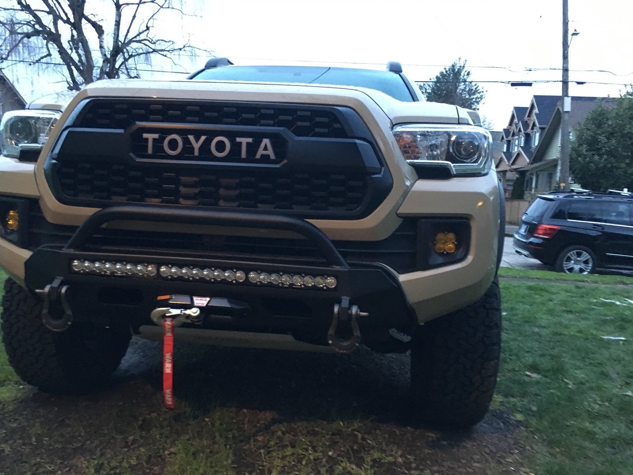

    65049187-7048-4B79-8CEA-89DD21D4FA45.jpg 98983CCC-6C55-4C55-A83D-D3845B8BD183.jpg Loving my SSO and Bajadesigns setup
    I ended up with the Warn VR-10s and epic shackles. I need to take better pics of the truck. When I do my spring detail I’ll post up some good ones.

    I think the easiest way to see the difference is to open up two browser windows of this thread and then look at the top view of the truck in in the lower left pic of Post #50 and compare that to the 3rd picture of my post #765. I took a 4' straight edge and marked and cut straight across where as in Post #50 it is curved which is what you get with the directions. Also, since don't have the hoop up top, that makes a difference to the top cut line I'm sure since SSO has to put out a single set of directions to make life easier for them. The second difference if shown in Post #90 when you look at the 1st picture...the corners appear rounded when you bolt up the bumper where as the marks and cuts I made are more contoured to the shape of the bumper and fit cosmetically a little better in my opinion as can be seen in my Post #765 in the 4th picture. Subtle differences certainly.

    Looking at the pictures I noticed straight away that you cut a straight line across the bumper, instead of following the curved edge, as suggested in the instructions.
    That was my thought also, therefore I was wondering if you could measure the distance at the edge of your bumper to the black plastic trim as shown in the picture below.
    Another member provided 1 1/4" with the traditional (curved installation), maybe you can confirm or provide different measurement due to adjusted cut line.

    2" ...I followed the taping instruction in the material exactly and then decided to cut it straight across so I just grabbed a 4' straight edge and drew the line on the tape. Then I adjusted the side cuts to match up with the new top line. No real plan ahead of time, just happened and then I started cutting.

    When I compare the picture you posted from the one I copied from the forum, one can tell, that you metal bumper is tucked further under the plastic, I believe.
    As I have a hoop, I will likely run into issues there and will probably end up close to the 1 1/4.

    I agree with your assessment give that you have the hoop.

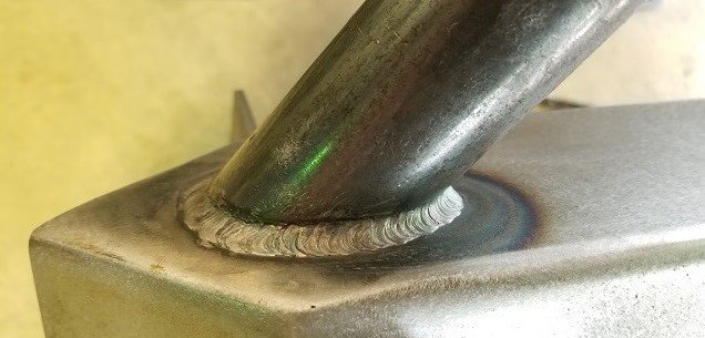

    Super nice install! Can we use these pictures on social media?
    Also, we were so jealous of your tig welding skills, we've begun tig welding our bull bars and pad eyes. This ensures ultimate strength and uniformity in the weld, as you know, and we're excited to be the only company (as far as i know) offering this on every slimline bumper we make. Thank you for being our customer and helping us to improve our process all around.
