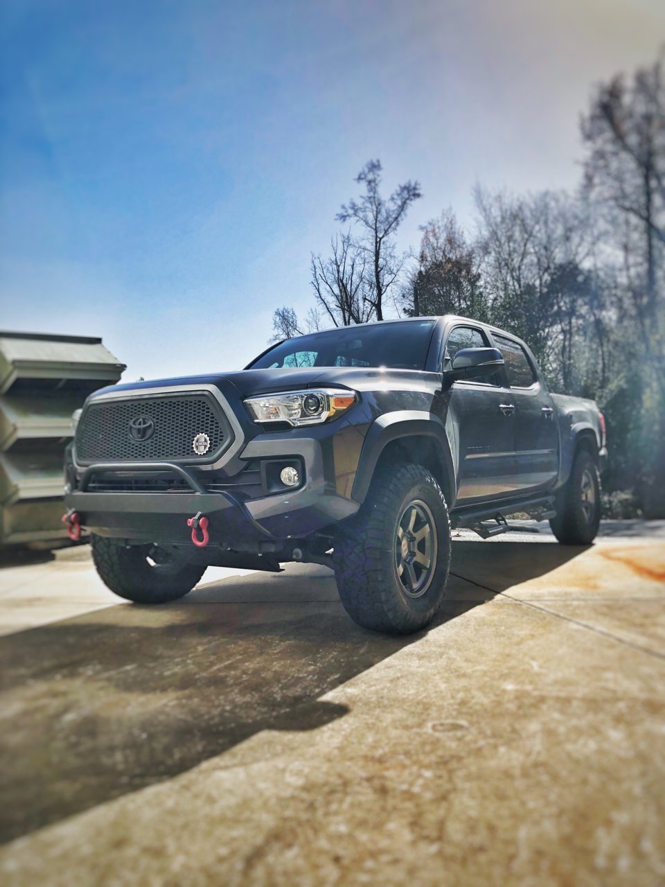

    johnnyflyfish
    johnnyflyfish New Member
    Dec 11, 2018
    #275580
    3
