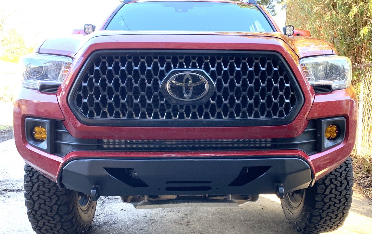

    Another update: currently At Powder Coating
    Can't wait!

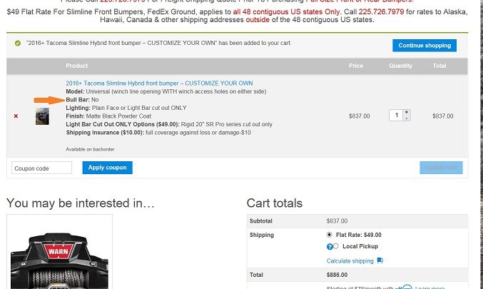

    Is there a way to get this bumper without the loop?

    So group guy?

    It's one of the options you choose from.
