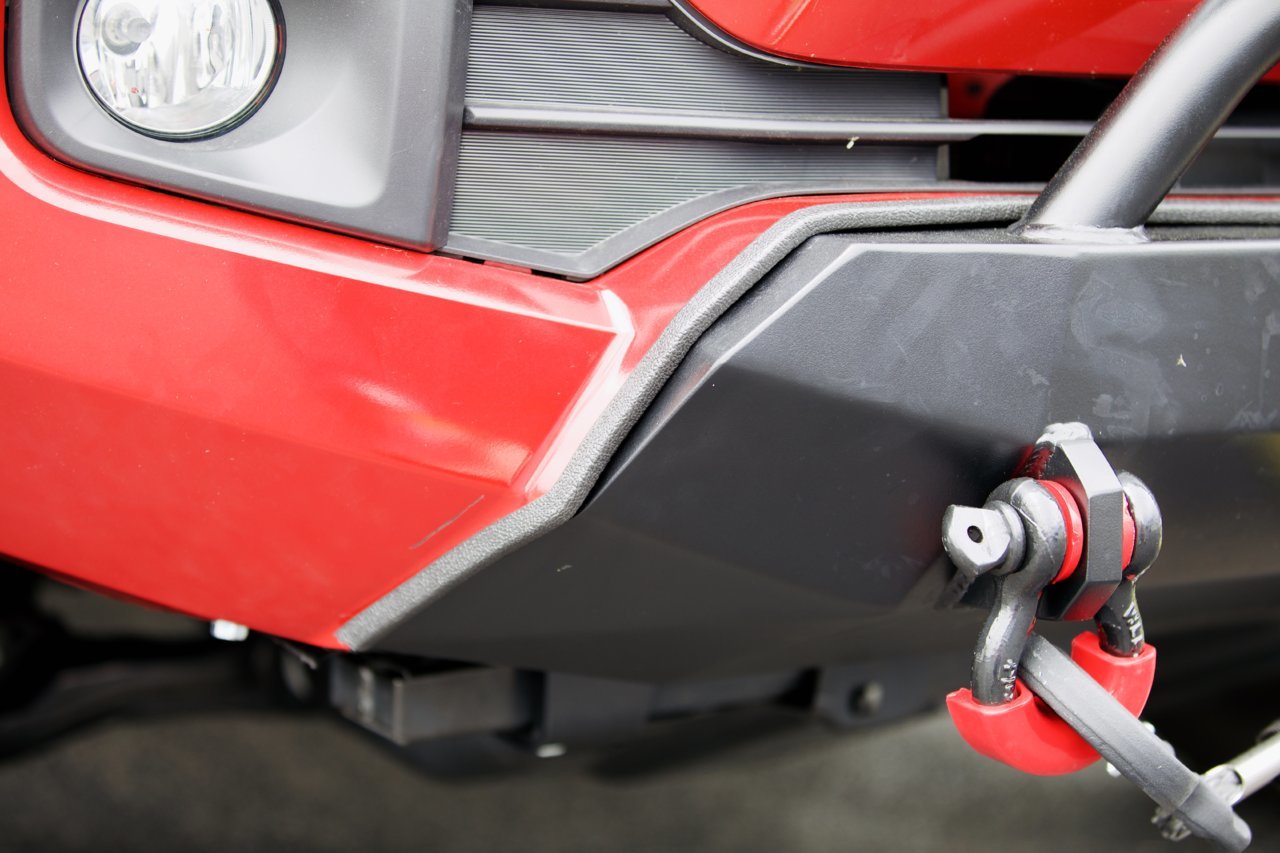

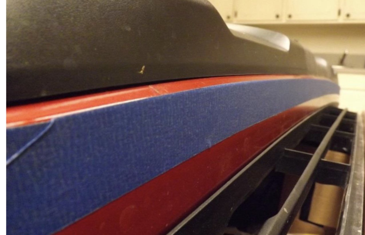

    Ok, I’m going to go lay out my cut line, which one did y’all go with, the one on this forum or the one from SSO.
    This one looks like the tape is folded down a good bit on the front which will of course leave more of the plastic vs the next pic.
    This one from SSO has the tape level with the entire front edge. This will remove more material from the plastic part.

    Imo over hang it. Cut less plastic

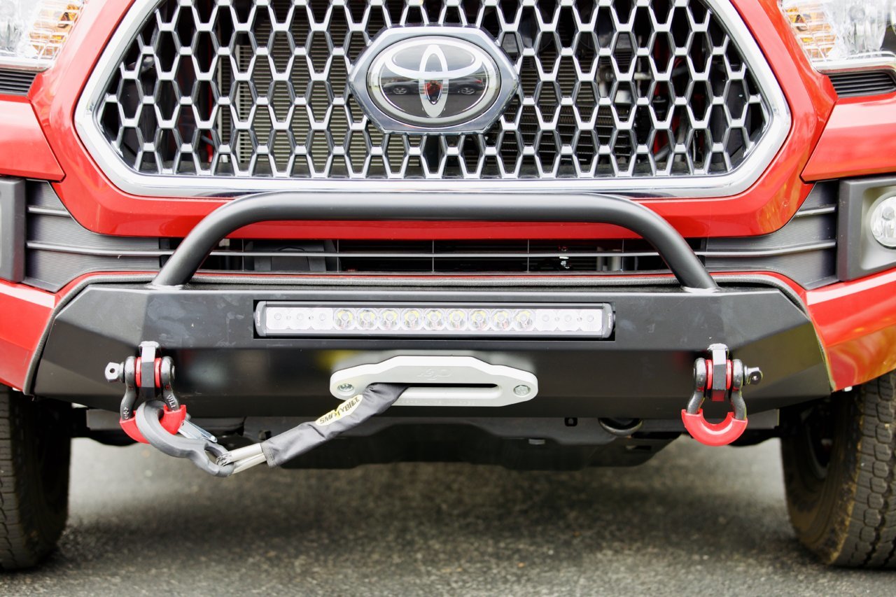

    Well just a quick update, the cut is done, everything the instructions says to remove is piled up in my garage and I’m at a point where it says to start installing the new bumper but I don’t have a floor jack here so this will happen tomorrow I hope. One thing I have yet to do is remove the grill and unless it’s impossible to get the wiring done without removing it I’m not going to.

    The install is finally done, just used a floor jack and it’s wasn’t to bad. I do have a few suggestions for SSO on their instruments and with a few changes they may not scare a few people off with what all they are telling you to remove. #1 No need to remove or even loosen the fenders and #2 I can’t see why everyone is removing the grill, didn’t touch mine and had no issues. I am just into the 3rd hour and all I like is the final wiring for the light bar. Everyone that saw this absolutely loves the way it looks!

    Can you post a pic of the gap please? What cutting guide method did you go with? Nice job!

    In my post 925 above, I used the modified method and taped it just like the tape is in the first pic. Had I used the SSO method I would of removed way to much material and it would of left a gap I would not of been happy with. If I was doing another one I would go even more than the 3/8 modified line that’s shown down the sides. You can take more off later but you can’t put it back on. The 3/8 modification would be the bare minimum.
    The tape line does work great for the top of the bumper as any more material up there would of hit my bar so that line is great. I wish SSO would come up with a guide that you lay down, mark or something, would really help everyone out.

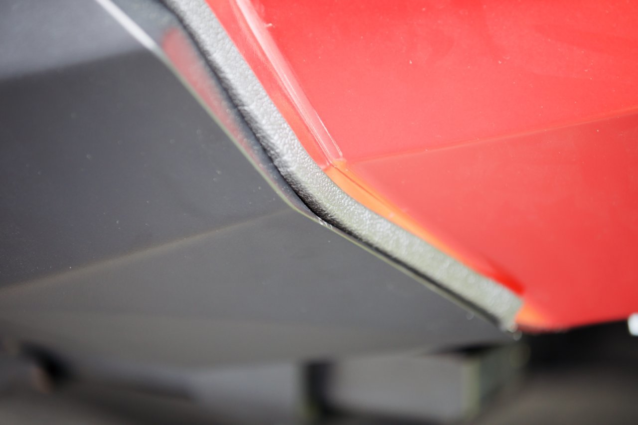

    Driver side:

    That is super clean, thanks for the reply!

    I did one a few months ago and did the modified cut line that’s shown in this thread and wish I’d even left more at the end of the day but I’m still happy with it though. I’d posted earlier that if I had it to do over with I’d leave a bunch more material and trim as I was installing. It would be a bigger pain especially where I was by myself.
