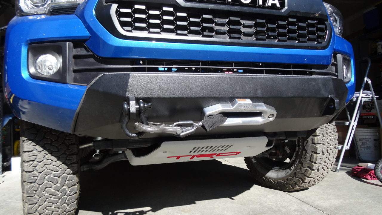

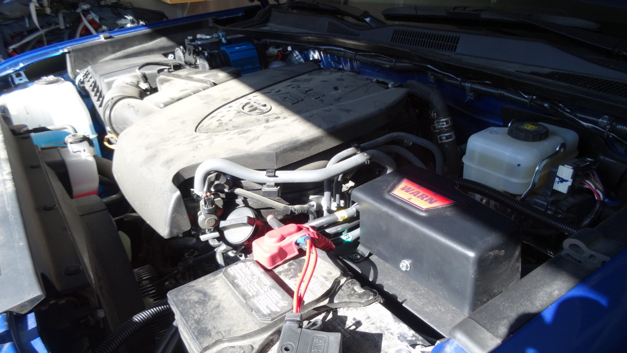

    Mine took over 19 weeks and finally decided to install it this weekend. I've read some people have left the control pack on some winches like the Warn VR10-s but the 10S Zeon Platinum is almost 3/4 of inch higher so it would be impossible to fit even with bending the bracket. So I went with the relocation pack and installed it on top of the fuse lid. Lid is still easy to remove with just having to remove the positive terminal on the battery which should be done anyway when doing any electrical work. Pretty straightforward install and did it all myself so as long as you have a jack no other parties are needed to install the bumper. Highly recommend the Zeon Platinum winches as they are fully wireless controlled and you can also hook up other accessories to it like lights and have the ability to control them with just the wireless remote so no in dash switches are necessary. I'm running OME BP51 rears with HeadStrongs 3 leaf and left the overload in and the fronts are the Bilstein 6112 with the HD 650 springs. Front dropped just under 1/4" so wasn't too bad. Still have another clip left if I want to raise the front end more but more than likely I'll be upgrading to the BP51's for the fronts also.
    Next up is the much needed 4.88 gears. Also having an ARB front air locker installed at the same time.

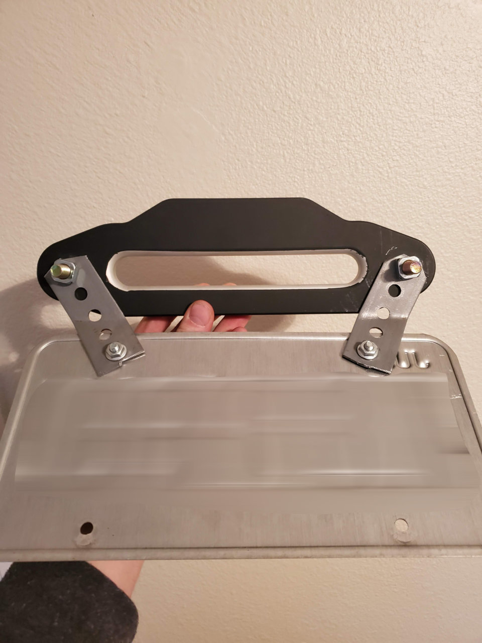

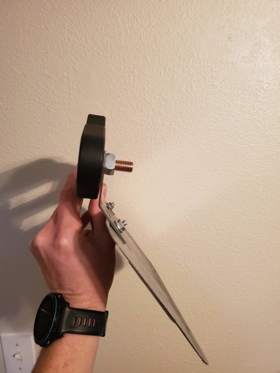

    Bored today so I tried to prototype how I'm going to attach my front plate when my bumper comes in. Don't really like the idea of the flip up holders and think this might be at least semi-legal. I'll use some bar stock without pre-drilled holes and paint it up before the final install. Anyone else try something like this?

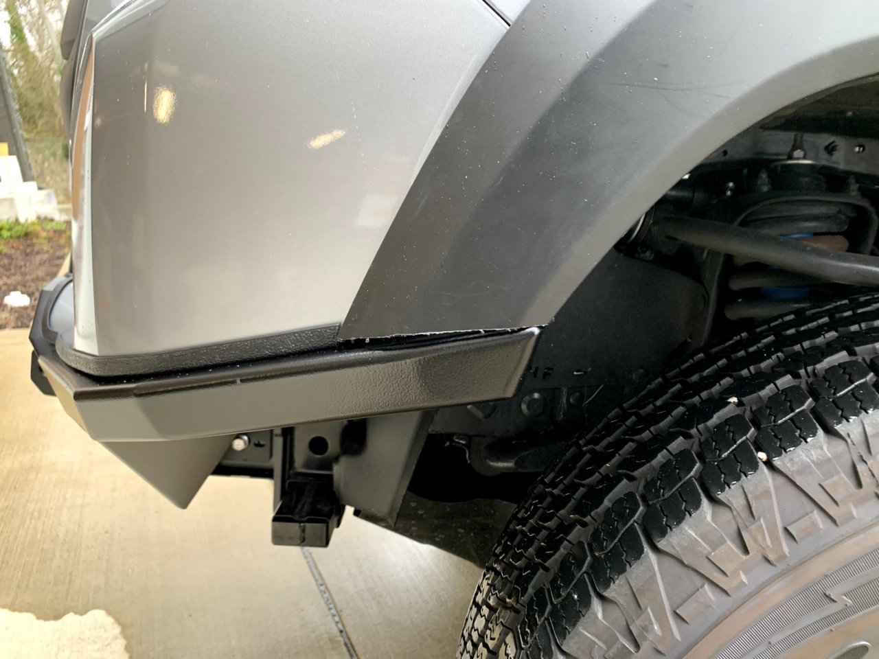

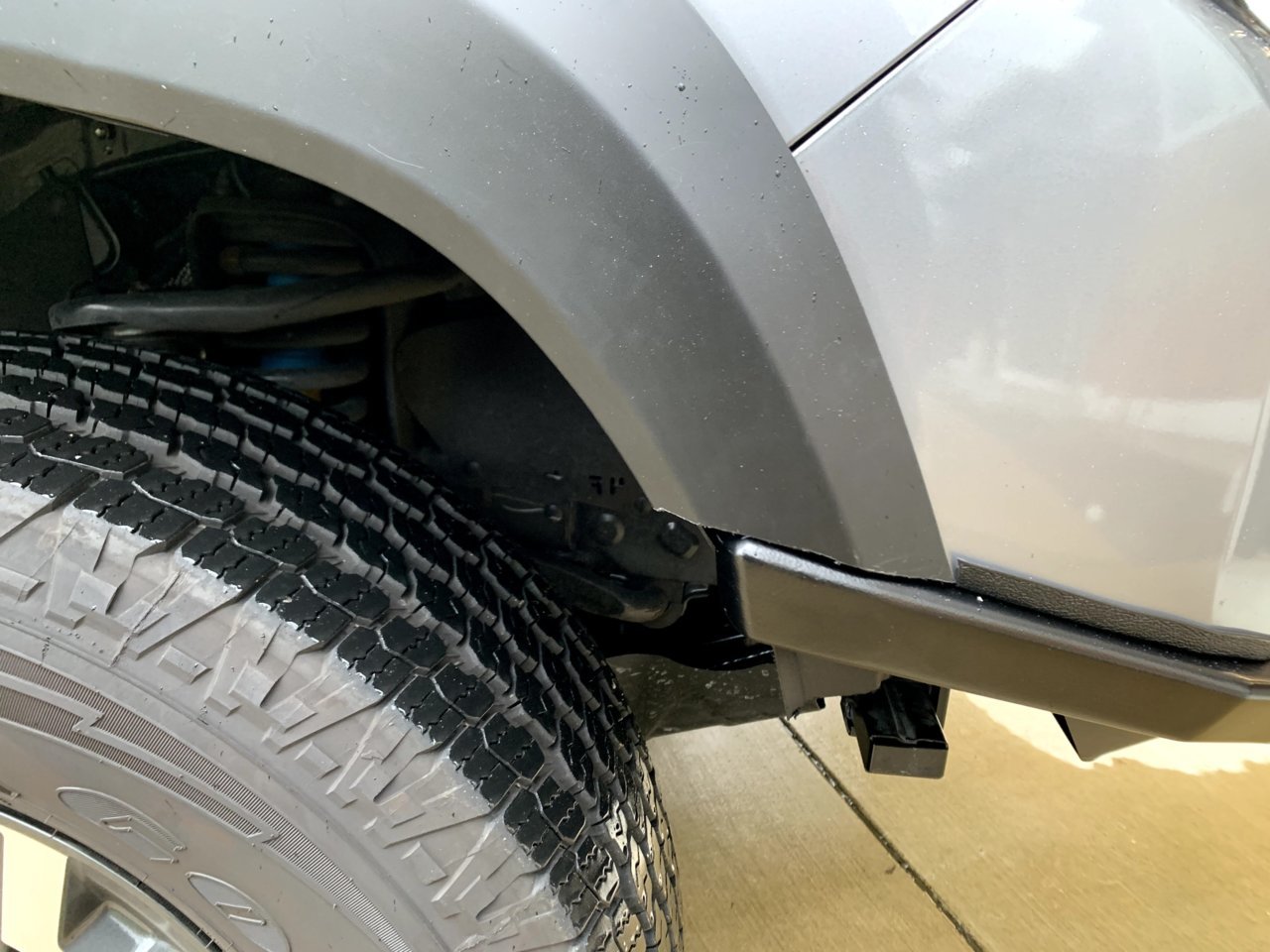

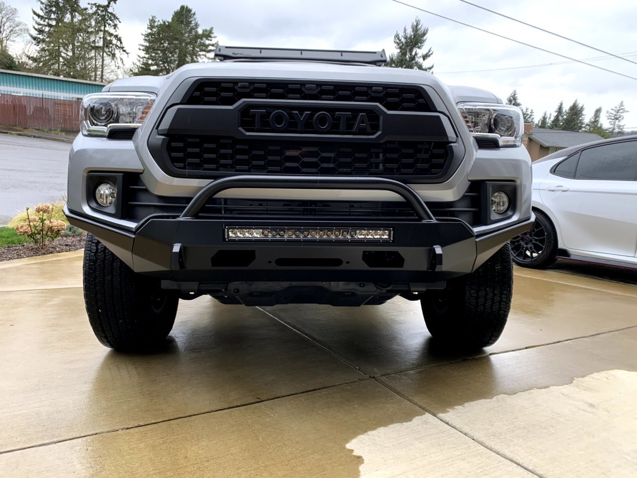

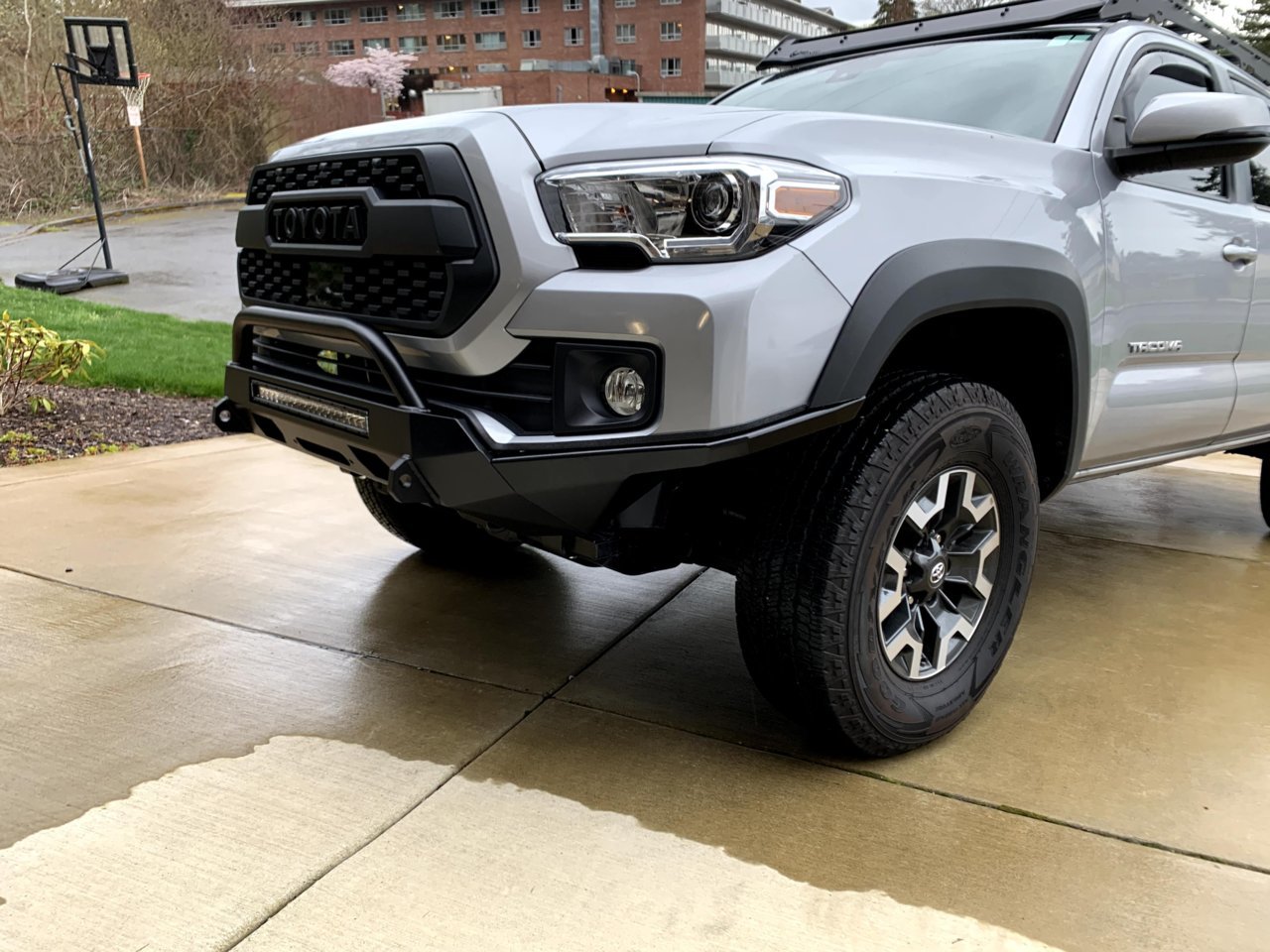

    Ordered my Slimline Stage 2 on Black Friday. Packages were delivered at different times: wings first, light at second, and main bumper last. Took about 4 hours to install everything – pretty straight forward.
    The only bummer I’m experiencing with mine is that the wings don’t line up perfectly with the wheel wells. The driver side is right on the money, and the passenger side is nearly an inch shy. I was told that the way the body mounts to the frame can vary from truck to truck. I tried everything to get it even, but closing the gap in one spot introduced a gap in another, so I left it as is. It’s going to drive the OCD in me nuts!
    For anyone that has installed this with similar fitment issues, what did you do? Is it a pain in the ass to adjust the body to the frame to get everything to line up?
