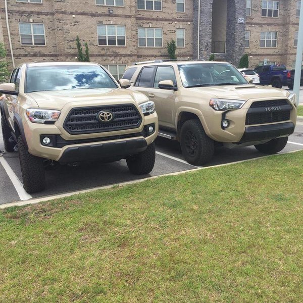

    i did mine like that! love it!

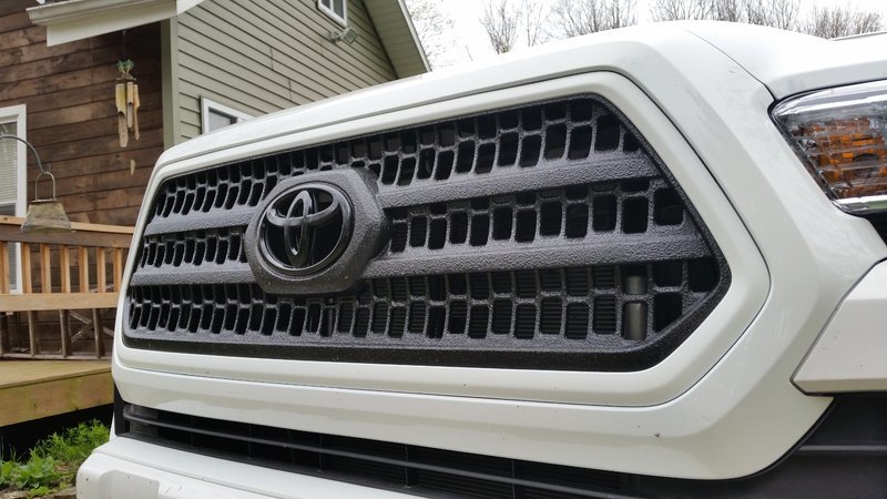

    I did mine with upol raptor liner. I have zero concerns of it holding up, did the same on my 03 and it looked great with zero chips after 4 years and 75k miles. Plus I only have about 30$ invested. If you don't have the gun and hardner you're looking at a bit more.

    Was that applied directly on top of the chrome or was the chrome removed?

    whatever they use to "chrome"that plastic is some tough stuff. It's all about prep, gotta really sand it good, I went 80 grit followed by adhesion promoter.

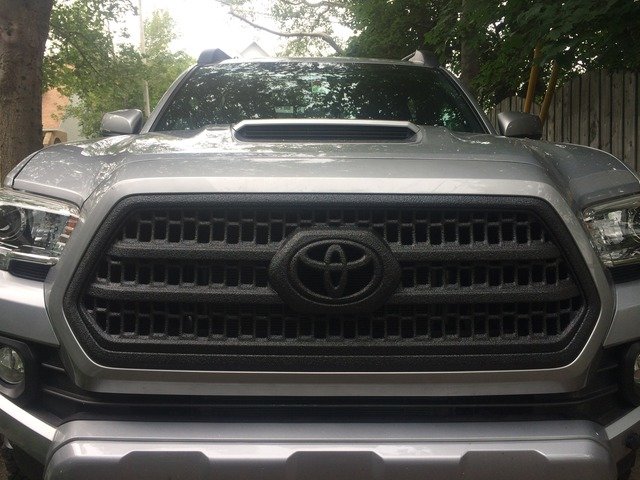

    I had mine sprayed today with Line-X, I love the look!

    How much did your Line-X dealer charge you? I went by my local shop today and the guy quoted me at $300 to do this.

    $125 CAD plus tax, but I disassembled the grill and brought it in to them for spraying, likely would have been more if they did it all.
