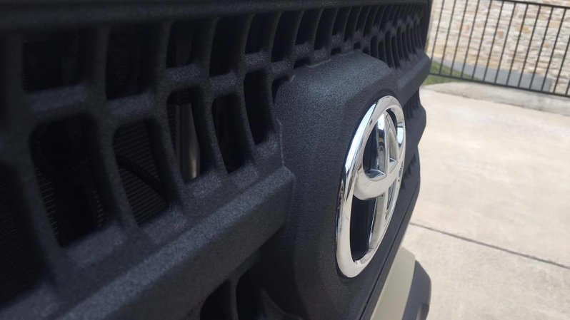

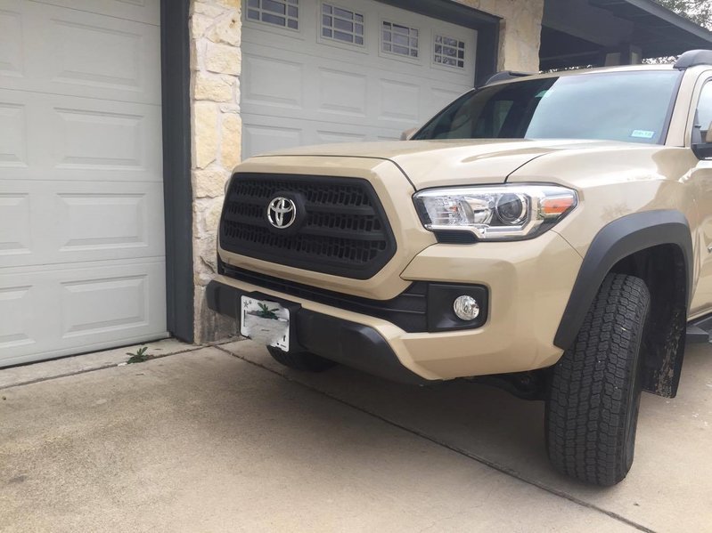

    Another option is DIY bed liner instead of plastidip or commercial bedliner. Took a couple of hours and a total of $12.00. Looks great and should last forever.
    Buy a 300 grit 3M Scuff Pad and the blue can of Duplicolor bedliner spray and get to work.
    Remove and disassemble grill
    Use scuff pad and rough up the chrome thoroughly. It looks like stainless steel when done.
    Spray light coats of Bedliner from 6-9" from surface moving can rapidly.
    Alternate angle of can for each coat to ensure complete coverage. Wait 5 minutes between coats.
    Keep spraying additional coats until the can is gone.

    Just did my grill yesterday following this procedure. It turned out great!

    I also followed these directions, worked out great.

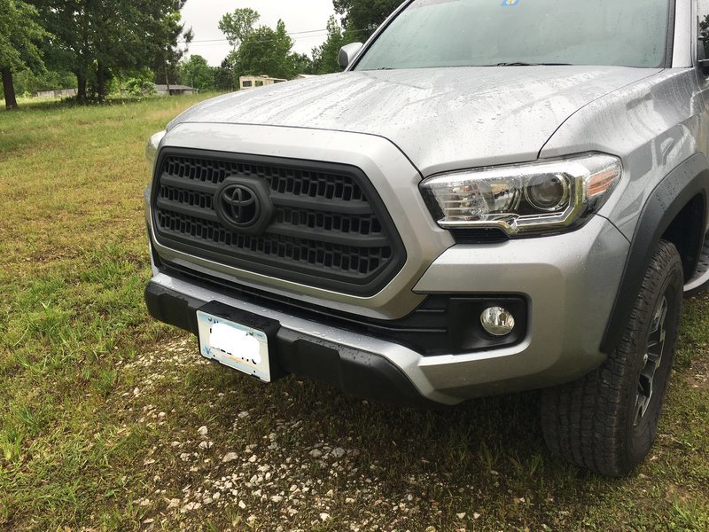

    Looks like a few guys have done the duplicolor bedliner spray. Looks great.
    Appears to have a slight sheen in the pics... is this pretty accurate?

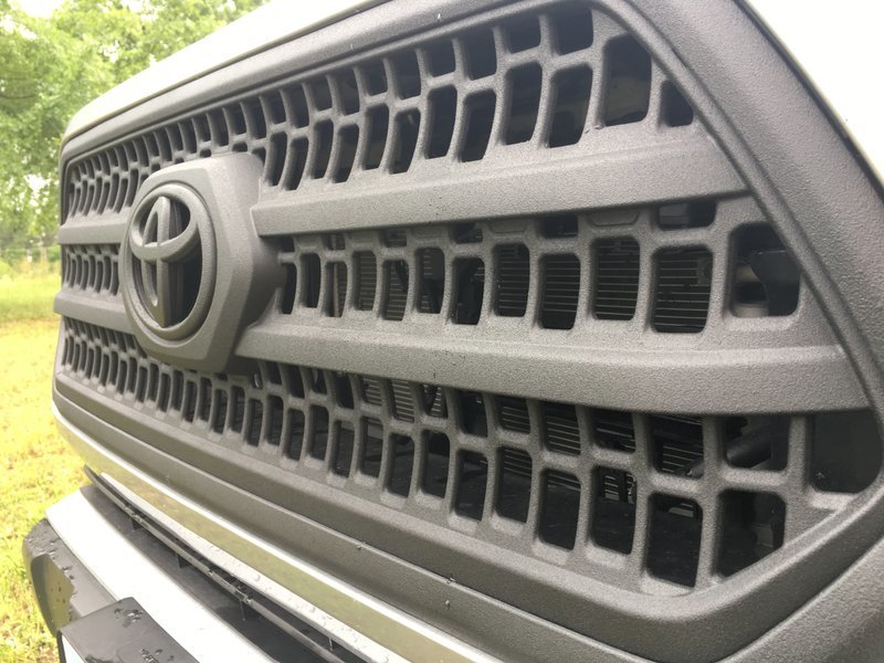

    Here is a close up picture of mine, it matches the fenders of my off-road perfectly. Very happy with the way it turned out. It has only been a few weeks, but it still looks like it did when I did it

    Thanks for the reply! looks pretty good.
    Kind of looks satin but maybe more on the matte side?
