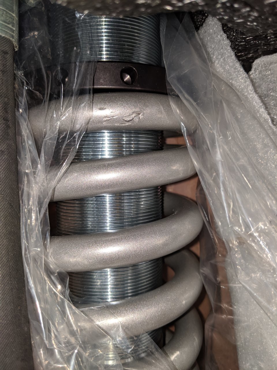

    So I got my springs from a local shop... And One of them is damaged from shipping, looks like the bracket got crushed on the coil over.
    This is the side that faces outward ....
    Will this be visible?
    I'm thinking I should return, cause I don't want to see this constantly.... It's on driver side :-(
    What do you guys think?

    Sounds like you might be building a show truck since your thinking 22-24” wheels, ifs that’s the case you don’t want a scratched coil, if you were building a off road rig you would give a heck cause they’d get scratched up anyways.
    photogr4x4 likes this.

    I'm gonna just compress the coil and turn it :-( they said they would swap it out but I have to wait for next shipment.
