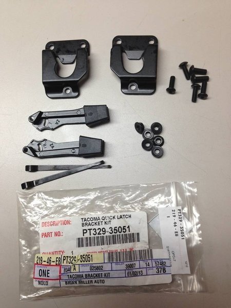

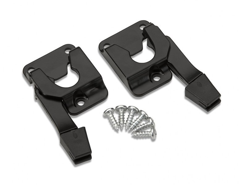

    One more thing to add. I ordered the Quick Latch mounts from Amp to replace the OEM ones that came on my truck. That way I could squeeze my ATV in the bed and not have to angle the extender to attach it with the ATV tires in the way. The mounting holes match perfectly and the OEM ones are through bolted. You simply have to remove the tail light (two bolts) to get to the nuts. I don't know about you guys but I'll take a nut and bolt over a sheet metal screw any day. These are the ones I got.

    These things are excellent! Very easy to install, and really make taking the bed extender in and out very simple. I needed these for when we load the back of the truck up with items to sell at the flea market.

    Why is yours all apart?

    Interesting. I got mine from AMP and it came assembled but with crappy sheet metal screws.

    I ordered from Amazon, it was together and came with stainless steel screws.

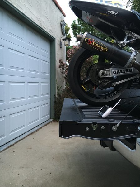

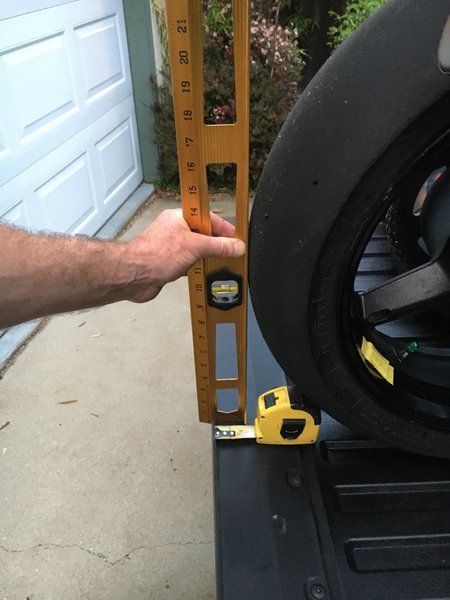

    Stan: Can you provide an update on your installation? I also want to fit two sportbikes in my short bed. The 2016 bed is taller than previous models, so in turn the tailgate is longer. For my bikes, the extender would need to reach all the way to the very end of the tailgate in order to clear the rear motorcycle tires. According to AMP Research, they are still developing a product for the 2016s, and the current model will not be long enough to reach the end of the tailgate, and if custom fabricated to be longer would hit the wheelwells when folded in.
    So, Did you get yours to work?

    I actually sold my OEM extender prior to installing it. I got myself a ready ramp instead. Looking at your pics with the bike installed, it seems now that the OEM extender will NOT extend enough. The ready ramp is nice because it is somewhat adjustable in placement. I still have not used it with my bike though - but i'm sure it will work.
