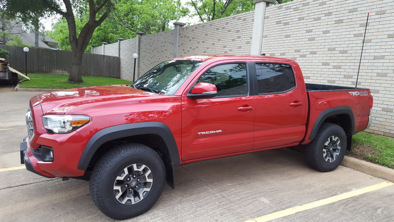

    Unrelated to your issue, but where did you mount your mic?

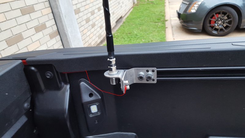

    Is that antenna mounted to a metal part of the truck or the composite bed. It needs to be mounted on metal that has continuity with the chassis. As someone else said, your truck is the other half of the antenna.

    The antenna is mounted on a mount attached to the bed rail. I also wired a ground wire that is attached to the body right under the black plastic on top of the bed sides.

    I would double and triple check that ground. You might want to use a braided strap.

    The red paint edit is where I located my ground wire. I'll add a second ground wire directly to the frame. I also ordered a new coaxial cable to make sure its not the cheap cable.
