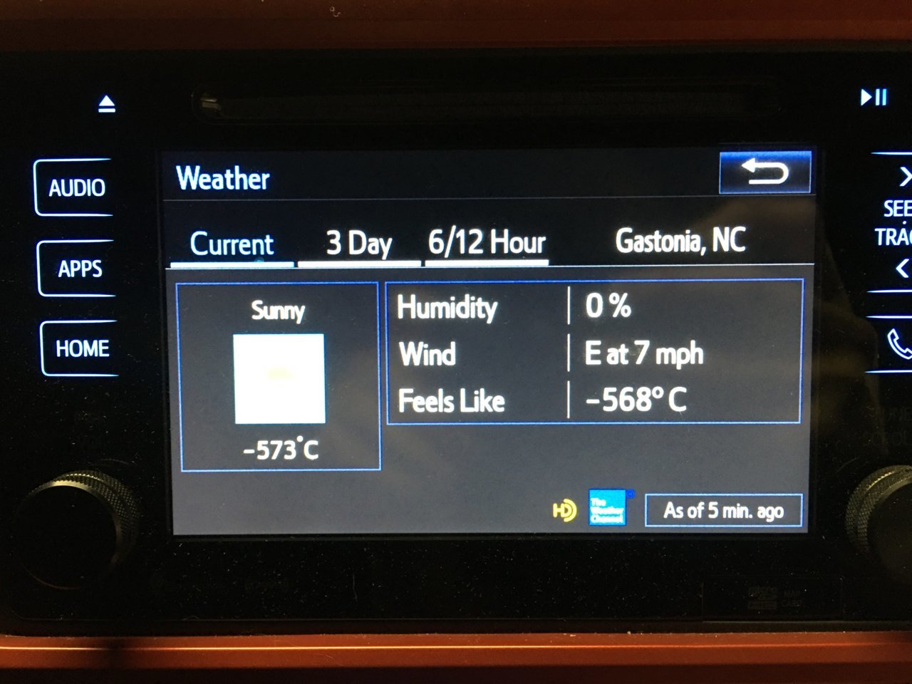

    The temp setting in the head unit doesn’t work. Apparently it’s quite cold out today :anonymous:

    Thats starts at 0 Kelvin

    we are into the negative Kelvin’s at this temp
