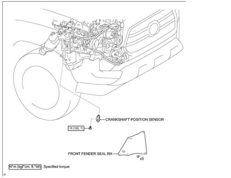

  18. Oct 15, 2016 at 7:05 AM

  19. Oct 15, 2016 at 7:38 AM
    #179
    swimmer
    swimmer Well-Known Member
    Apr 21, 2015
    #153626
    2,527
    Tucson
    2016 TRDORAC4WD
    No need to. That circuit is dead if the ignition is off.
    nevadabugle[QUOTED] likes this.
  20. Oct 15, 2016 at 7:39 AM
    #180
    swimmer
    Apr 21, 2015
    #153626
    2,527
    Tucson
    2016 TRDORAC4WD
    Yes. Just remove the top two pins and let the rubber piece fold down.
