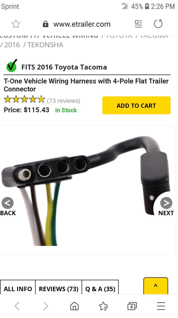

    So basically just using a wire connector for each one and clamping them down and maybe some electrical tape or use that heat method i saw them do on the etrailer video.
  14. Apr 23, 2019 at 2:21 PM
    #94
    moe2o4
    moe2o4 Well-Known Member
    Feb 9, 2015
    #148236
    7,858
    Corey
    Pittsburgh PA
    2016 SR Silver 2.7L 5 Speed
    OME 3" Lift, 32" Tires, Lots of Mods!
    Yep!
  15. Apr 23, 2019 at 2:29 PM
    #95
    Monopod
    Monopod Well-Known Member
    Jan 29, 2017
    #208973
    414
    2017 Silver sky tacoma SR I4 4x4
    plasti dip emblems, TRD off road wheels, pro clips cell phone mount. 20 percent tint.
    So this piece im cutting from the harness then attaching it to the factory look alike plug wires ect...
