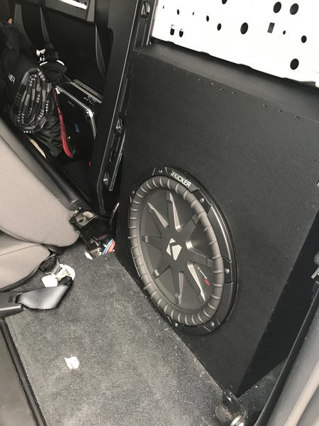

    Hey all,
    After scouring this site for subwoofer box dimensions for my 2016 Tacoma Sport DBCB, I came up empty handed. So I decided to give it a try. I have built boxes before, but not to this detail. I would say have approx. 18 hours in this build including wiring. Taking my time of course.
    *Please not this is not a How To. These are my dimensions and what I used to get there.
    1x - Sheet of 1/2" MDF
    2x - M6-1.00 x 30 Hex Cap screw
    2x - 1/4 x 1-1/2" Fender Washers
    2x - 1/4 x 1-1/2 x 1/16" Rubber Washers
    2x - 1/4" Lock Washers
    1x - tube of DAP Silicone
    1x - Duplicolor Bed Armor spray
    I had to use a shallow mount sub as there is only roughly 4 inches of top mounting depth.
    I went ahead and got the Kicker CompRT 12".

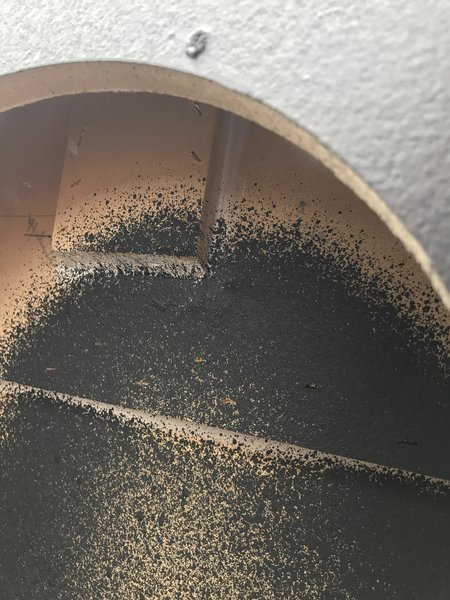

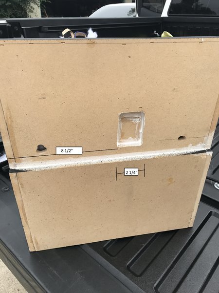

    This was a tricky part. I had to cut out a square to account for the bracket that is affixed to the rear of the truck. I then cut out a separate square of MDF to recess the hole. Then if you look close, I dremelled out a section to allow clearance for the bracket.

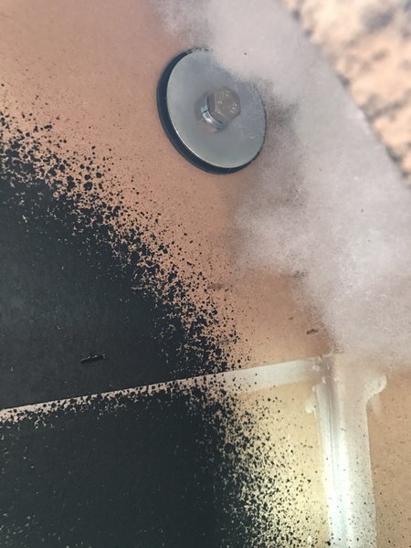

    The fender and rubber washers were used to secure the box to the back of the truck using the existing threads from the storage compartment that was removed.
    I hope this helps anyone who wants to attempt to make a box for themselves.
    I really enjoyed this build (my wife did not).
    The Kicker 12" is a great all around sub so far. Its not earth shattering, but I am very impressed with this sub. Nice clean sound that hits all the lows and highs.

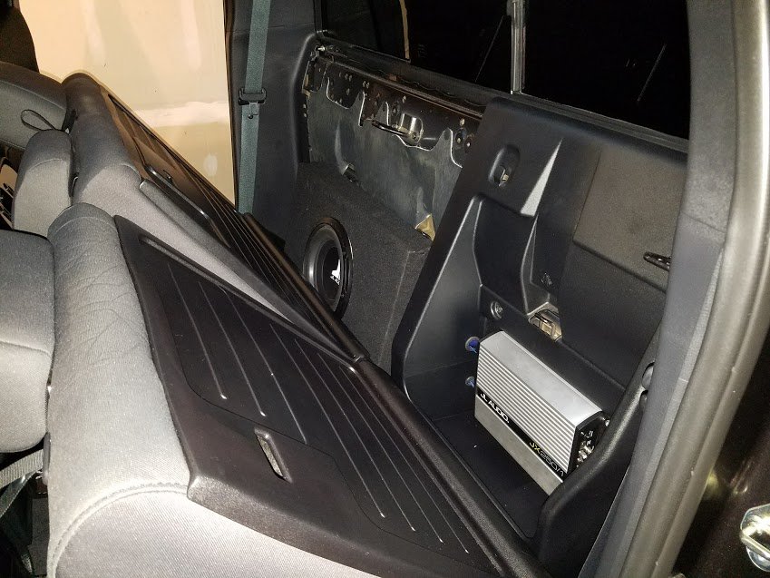

    FYI it's possible to get a little more depth out of your box with some creativity. I've got an Image Dynamics IDQ10, 5.81" mounting depth. What helped the most was taking out the plastic cover on the back of the seat. This is my old box, but same concept...
