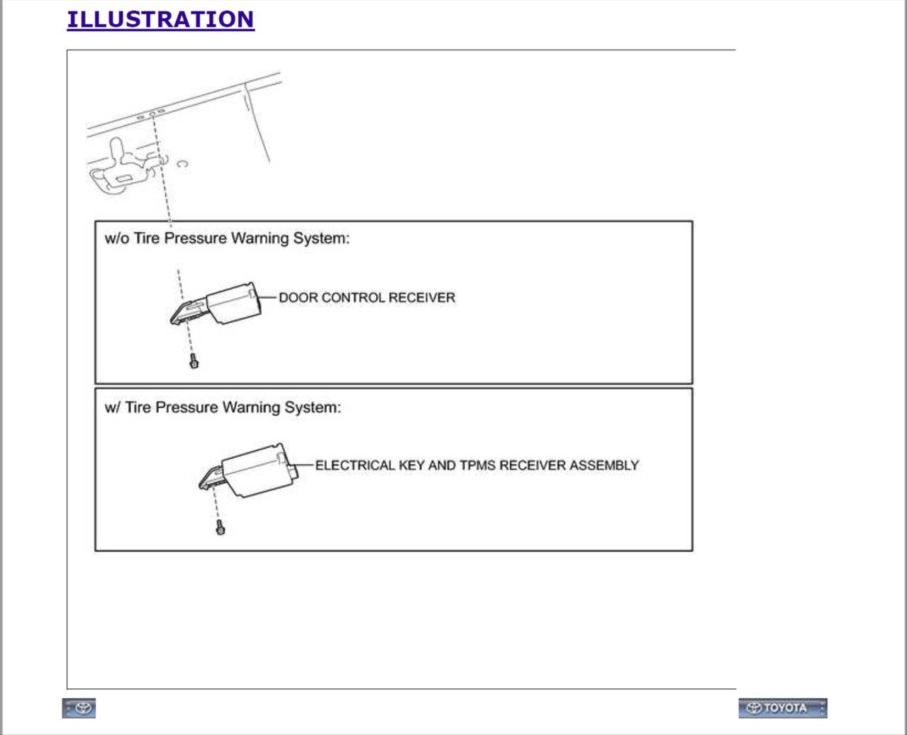

    The antenna in the overhead rear location is for the Tire Pressure Warning System.

    go to the door lock system in the manual. There is a receiver on the drivers side towards the back of the cab (so over rear seat). Further back than the one shown in that image and not central. One you show is not the one I referenced in my post

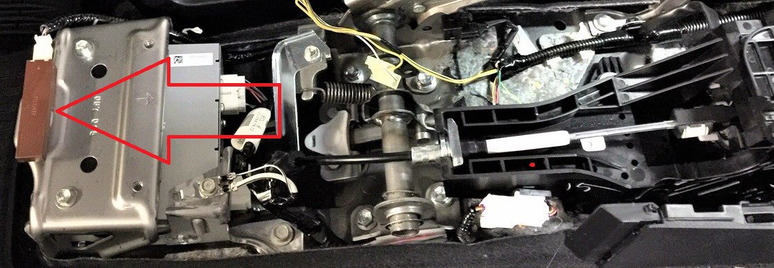

    Show me...the central antenna is inside the center console rearmost part.
    The one in the front is above the SRS ECU

    No. I’m at an airport on a phone and have better things to to than prove you wrong. You obviously have the information at your hands, look at either the exploded parts diagram of the keyless entry system or the diagnostic procedures of the system and you’d be blind to miss it. Or wait a few days when I’m in front of a computer and I’ll post a pic from the service manual.
    Edit. Quick google. Crap image compared to manual but you can see it.
    http://www.ttguide.net/images/books/171/E333586E05.png

    Y'all might be arguing over the same thing. It seems that the TPMS Receiver includes the electrical Key (Door Control Receiver) on vehicles that include TPMS.
    I think that might be all vehicles sold in the U.S.?

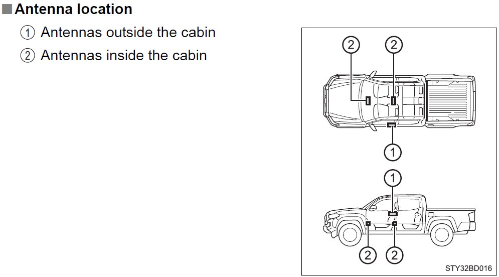

    The info now is, there are receiving antennas on driver's handle, 2 in the vehicle's center-line and, depending on "type", an extra one in the overhead.

    I simply looked in the FSM to try to find whatever mutely was talking about. But from the images and description I found it appears the devices in question are one in the same, located in the same headliner position.
    The device appears to be dual-function if the vehicle has TPMS, or single-function (door control only) if the vehicle doesn't have TPMS. From the images I found I can't really tell if the device is located in the center area of the headliner or the rear area.
