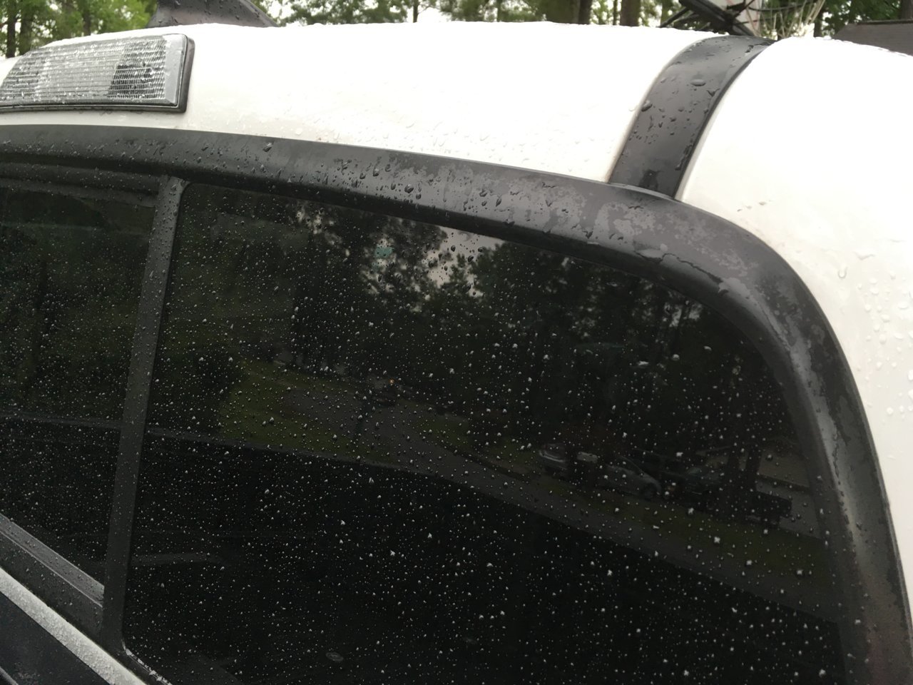

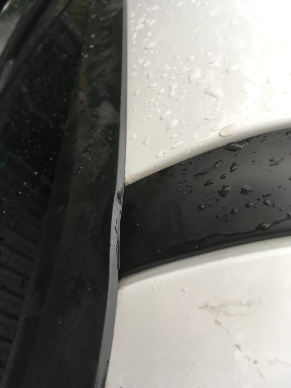

    C2189213-BA0B-4C44-9BFC-9585477B1B47.jpg D2993B71-7C41-4183-9830-881170A0AC7D.jpg I flipped back seat up today after a heavy rain and noticed water in storage area and figured out headliner was wet. I think it’s leaking around where the cab seals meet the window seals. Has anyone else experienced this? I’m going to try some 3m window sealer.

    Probably the center mounted brake light

    Lot's of reports on the brake light leaking. Check there first

    I just checked, and it is exactly that.

    Does anyone know if you can just seal the top of the light without taking it off?

    I had my third brake light replaced and sealed under warranty.... 2017 Off-Road

    I have the same problem also. I thought it was my rack on top that was the leak, but it wasn't until i did some testing. I was thinking of spraying flex seal inside the cab behind the headliner as I saw it seep through the crack where the window frame meets the truck frame. How did you fix yours?
