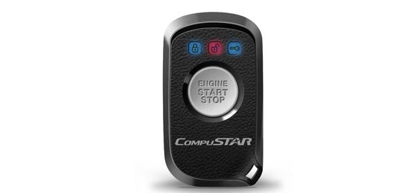

    Don't buy a cheap remote start, they can ruin vehicles and there is no warranty.
    If you want a small remote that is 2 way and can unlock the truck this is what I have. I love it.
    It is correct that all smart key vehicles shut down on entry, but its a minor inconvenience.

    Yes, definitely stick to known name brands for this stuff.
    As to a two way remote, from what I've gathered in my research that capability is typically an add-on module to systems which can also be setup to use the OEM key fob. The 2way modules do add some benefits, so they may be worth considering depending on your needs, but they're by no means the differentiator between good and bad systems.
