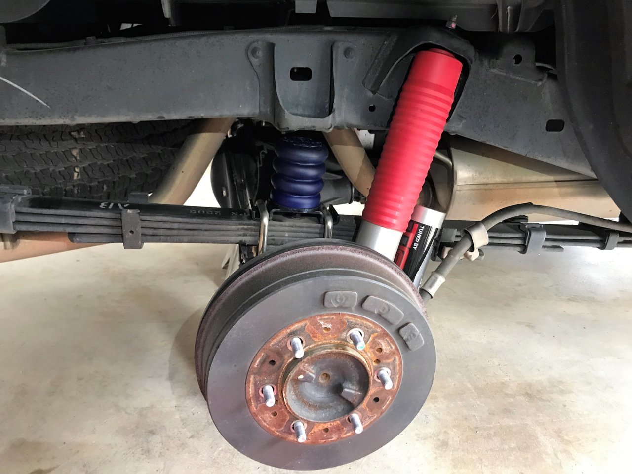

    I know this post is OLD, but thought I would put up a photo of the SumoSprings SSR-612-40's that I installed on my 2016 TRD OR. I went with the suggested part for my year model. They ride great, don't even know they are back there while not loaded. When towing the boat they do a great job at holding the rear end up, no harsh feeling when hitting bumps or RR tracks. With no load on the rear, there's about a 1/2 inch gap between the Sumo and the frame. When towing they come in contact with the frame, yet still provide a smooth ride.
    Totally happy with these.

    I'm glad you like them, but with the 610 and 612 set for my 2016 trd sport they were in contact with the bump stop perch 100% of the time and rode like garbage for me.
    I wonder if my leaf springs are damaged/bent/tired from towing my boat...

    It's hard to say why yours rode that way. I am about to install a 1/2 inch block under my leaf springs to raise the rear just a bit. At that point the Sumo's will probably be in contact with the frame all the time. If my ride quality changes I will let you know. My ride quality may be a result of the PRO shocks. They do provide an incredible amount of rebound. You can't compress them together by hand, and once they are compressed, they rebound with a vengeance.

    I bought the 612-47s originally, but then after adding a ARE cap, they bottomed out to hard. Switched to 610-47s and it rides much better. But yes, they touch the frame all the time.
