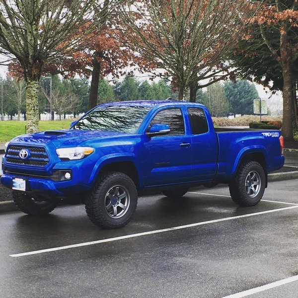

    Are you lifted at all, could be rear drive shaft out of alignment, and excessive movement from the carrier bearing.

    I have the 1/2" Toytec spacer up front to level me out.IMG_0135.jpg
