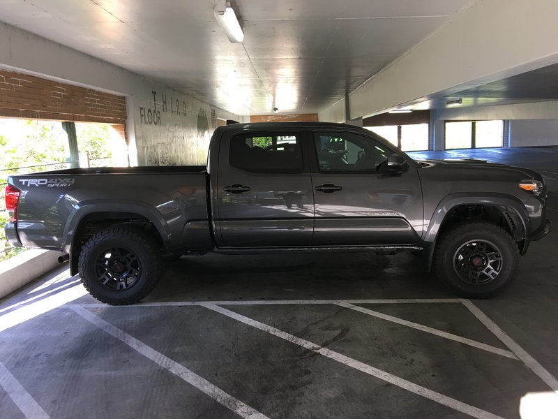

  16. Apr 14, 2017 at 8:22 AM
    #16
    grsctacoma
    grsctacoma Member
    Feb 10, 2016
    #177803
    16
    Santa Cruz
    2017 Tacoma DCLB Sport
  17. Apr 14, 2017 at 8:32 AM

  18. Apr 14, 2017 at 8:34 AM
    #18
    Bob1sh
    Bob1sh Well-Known Member
    Mar 5, 2017
    #212454
    162
    Zac
    2017 DCSB 4x4
    Are you using wheel spacers? Any straight on side shots? Truck looks great
  19. Apr 14, 2017 at 8:41 AM
    #19
    grsctacoma
    grsctacoma Member
    Feb 10, 2016
    #177803
    16
    Santa Cruz
  20. Apr 14, 2017 at 8:41 AM
    #20
    grsctacoma
    grsctacoma Member
    Feb 10, 2016
    #177803
    16
    Santa Cruz
    No spacers... thanks.
