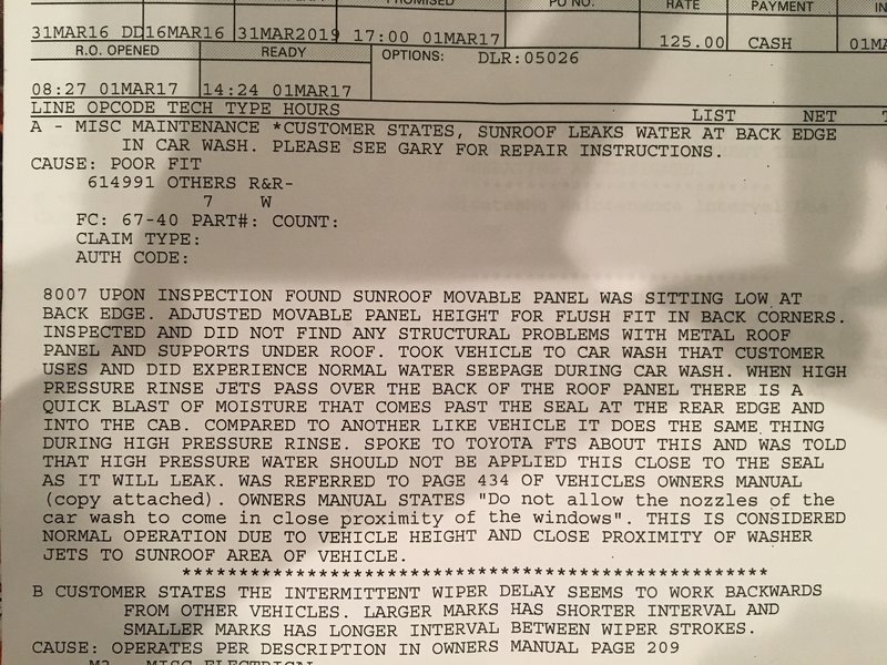

    Update on my leak.
    This is Toyota dealers reply. Basically adjusted some screws near sunroof to help make it "flatter" transition between metal and glass on rear-most part of sunroof- did not make a difference when going thru car wash. So basically, nothing they will do. Based on feedback from @M2loco, not gonna pursue trying to replace it.
    More annoying than anything else. I doubt in downpour rain it will pour in like in car wash. Still my 02 4Runner and '10 Lexus have NO issues going through same car wash!! Starting to question Toyota quality control or maybe just curse of buying first year of new model. Oddly enough, dealer told me a '17 Tacoma came in next day complaining of same issue and he goes to same car wash!
    At this point all I'm going to do is write lengthy letter to Customer Experience Center 800-331-4331 and tell them my disappointment in their QC department.
    On a slight tangent, I've heard of some TSBs on various issues and asked them update all of them on my truck. Only one I did was last year on the transmission when it was constantly shifting gears around 65 mph. Well, he said he can't do that. I have to come in and complain of specific issue. Also, Toyota does not issue a notice or post them since it is not a recall issue!! How stupid. I'm hoping there is a thread on all TSBs for the third gen!

    I would not call this normal but until people start complaining more Toyota will not do anything. Really questioning their quality when I see a failure like this. This coming from someone who has 3 Toyotas in his garage.

    I just texted my dad and asked if his 99 landcruiser built in 98 has a sunroof leak during this pissing Seattle rain. No, it does not and never has. Toyota quality aint what it used to be. Can't deny that.
    Sorry for the time that Toyota wasted OP. Good luck.
