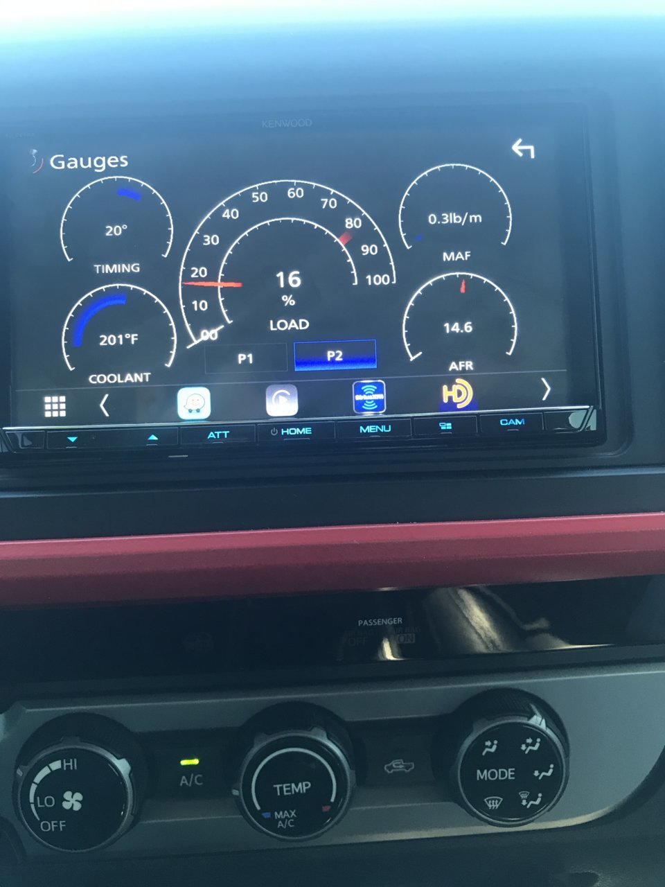

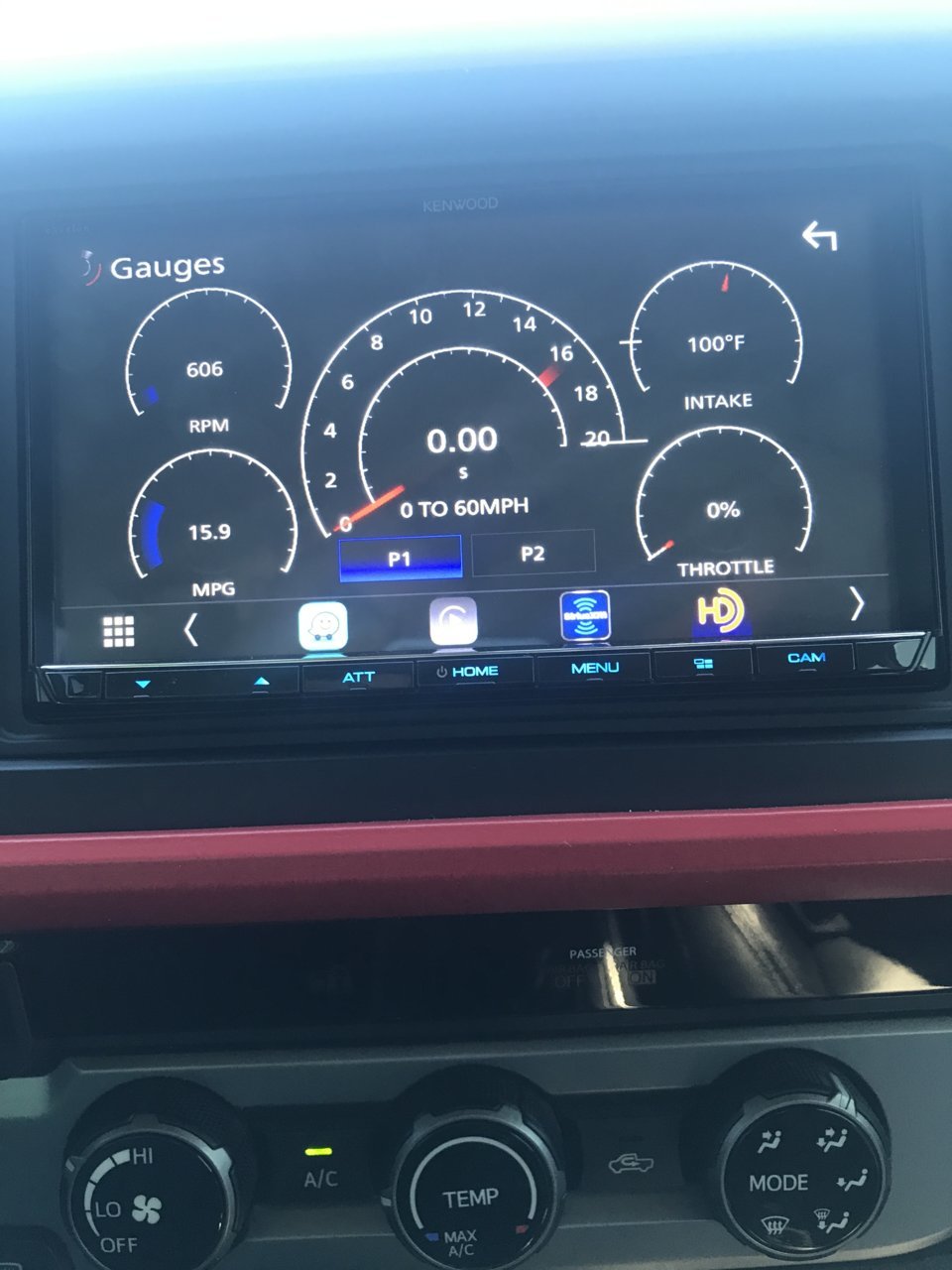

    Idatalink Maestro is where it’s at!!
