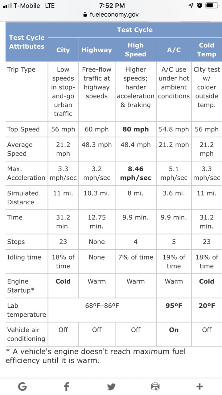

    I’ve said this before, but I’ll reiterate for the noobs. Fuel economy ratings on the window aren’t based on real world driving. I have seen so many complaints about mpgs being bad in these trucks. Drive your truck at 60mph and see how your mpgs compare to the window sticker.
    Recent EPA fuel economy test from the EPA website:
    Notice the amount of time spent at each speed.

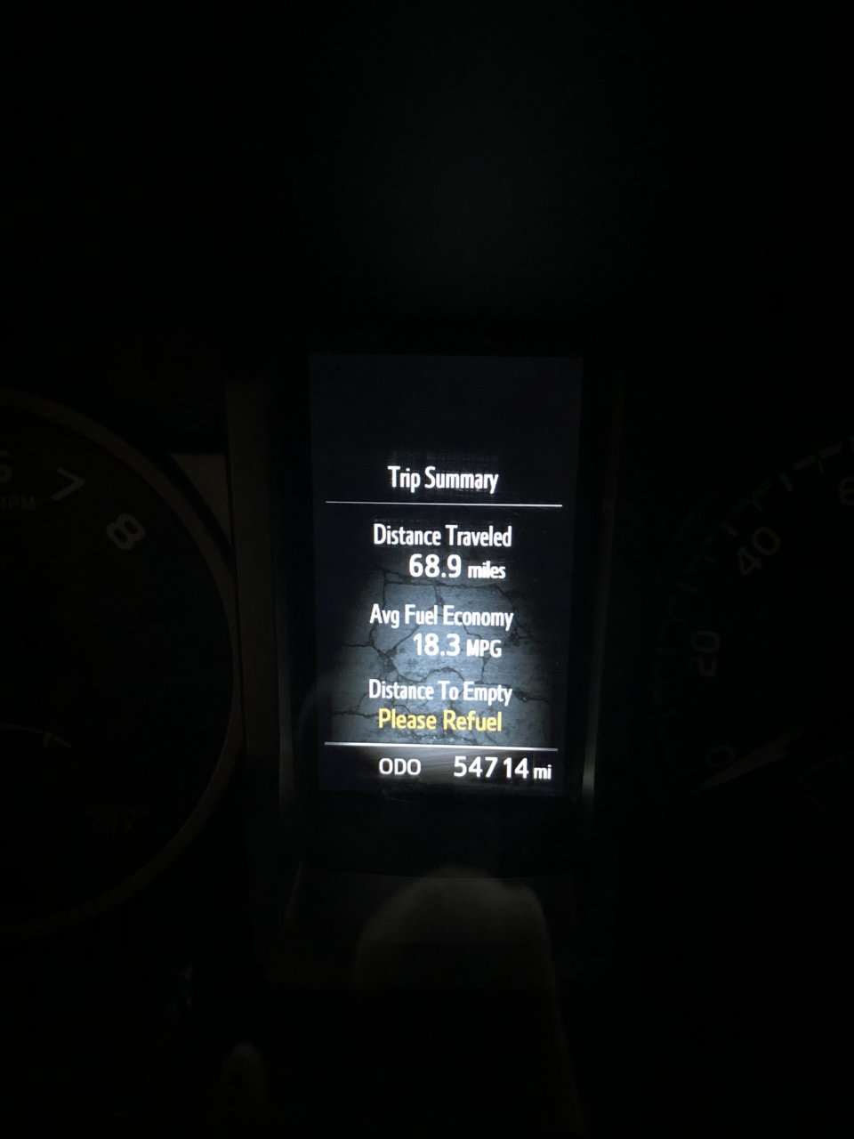

    A5913531-951C-44F4-8F15-40AD0E682F3F.jpg 87F3BB1C-8FDA-466F-841D-0D141B9645A5.jpg
    The previous times I made this trip, I didn’t do better than 19 mpg. And that was when the truck was 200 lbs lighter.
