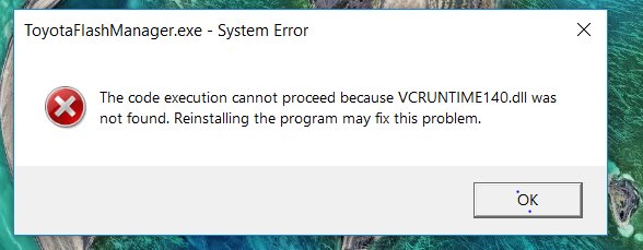

    I've been trying to install the new flash manager. I keep receiving this message when attempting to run the file after installing. Thoughts?

    Do you use iOS or Android?

    I had this same error too - I had to go to Microsoft download center and download/install "microsoft c++ redistributable" which reinstalled that .dll file and then it worked smoothly

    That worked perfectly! Thank you!
