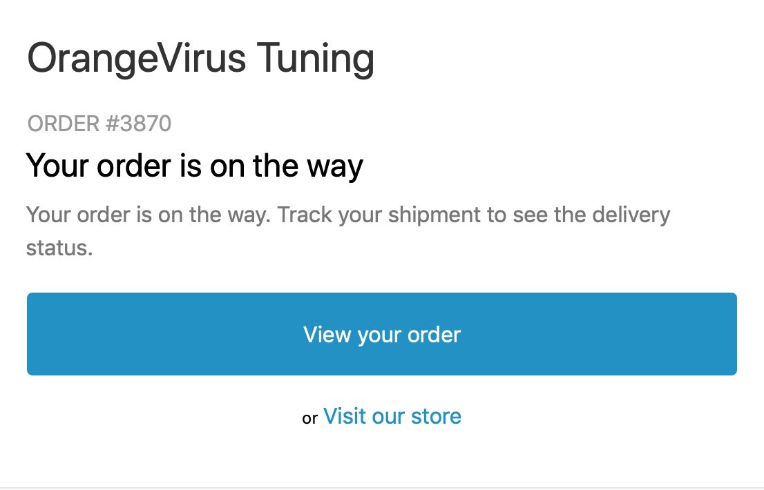

  13. Feb 20, 2019 at 9:50 AM
    Wixo
    Wixo Platinum+ Member
    Dec 12, 2016
    #204665
    4,142
    Hank
    ‘21 SR5 Tundra CM 5.7L Barcelona Red
    Tint, LED interior
    And now we wait...
