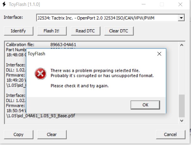

    Update what exactly? Here is the file I am attempting to flash.

    help>update in flash manager, toyflash should be a higher version than 1.1.0

    Thank you! That was a quick fix.
