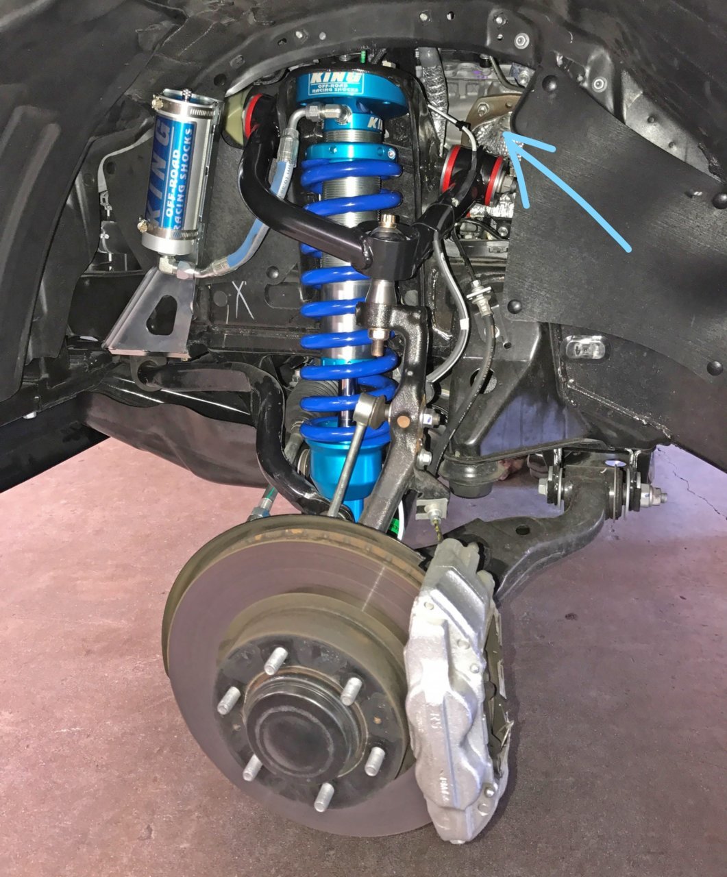

  4. Jun 14, 2019 at 5:15 PM
    uploadadventure
    uploadadventure It’s all @ColoradoTJ’s fault
    Jan 30, 2019
    #281288
    9,879
    Dixon, Mo
    2019 Cavalry Blue Tacoma TRD OR (sold) 05 Duramax
    I hate to have to do this on my 4 month old truck lol
    At least none of the bolts will be rusted.
  5. Jun 14, 2019 at 5:27 PM
    Phich
    Phich Porkchop Express
    Feb 17, 2017
    #210855
    949
    San Antonio
    2017 TRD Off Road tuned to KDMax perfection
    Six Demon Bag
    Dump tubes would be fairly easy.
    Bolts only. The bolts may be a little tough to break and not the easiest to reach, but no big deal. PB Blaster and elbow grease.
    The average joe, 1.5/2 hours tops.

  10. Jun 14, 2019 at 5:52 PM
    OVTune
    OVTune [OP] Well-Known Member
    Mar 27, 2017
    #214557
    8,112
    OVTune
    Each side :
    4 bolts connected to head, 12mm
    2 bolts connected to y pipe 14mm
    1 bolt connected to header bracket that attaches to block. (Can be used or deleted) 14mm
    1 02 sensor.
  11. Jun 14, 2019 at 5:53 PM
    OVTune
    Mar 27, 2017
    #214557
    8,112
    OVTune
    Yes, trying to fit 3 different turbo in several different orientations.
  12. Jun 14, 2019 at 5:54 PM
    TWTaco
    TWTaco Well-Known Member
    Dec 19, 2015
    #172601
    5,723
    Dave
    With the lift and bigger tires it looks like it will be pretty easy!
