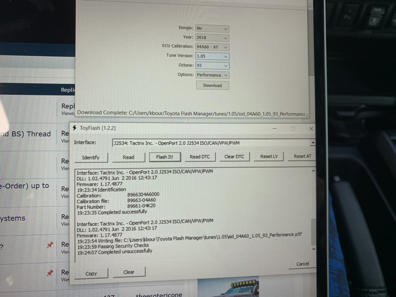

    Anyone familiar with this error? I get a completed unsuccessfully confirmation when it tries to pass “security checks”

    Well, I’m Pretty sure it’s because I have a USB3 port... unfortunately I only have USB 3 on my computer, I just saw this and it looks like
    I might be out of luck

    Well actually never mind, it’s not blue

    I had that same error a few times. I disabled windows defender and ran the program as administrator and it worked. I think it's a windows 10 problem. I now use a dedicated laptop running windows 7 and haven't had the issue.

    I’ll second this. Windows 10 is stupid. Especially if you keep it patched and updated. M$ likes to break things on the regular way more now than ever before.
    Mine has everything disabled and is only used for flashing.

    Also, make sure you are in the on position not accessory. (On but not running)

    Got it sorted, all I had to do was run as admin.
