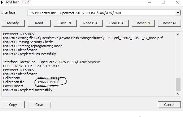

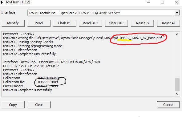

    That's a 04B02 file you're trying to flash to you 04B04 vehicle. Also, don't use the 1.05.1 file unless you have the specific symptoms it was intended to fix.

    It looks like the file you’re attempting to flash is for 04B02.
    Make sure you’re flashing the file for 04B04.

    yeah noticed that after posting. Went to re download for 04 and there are no options to Download for 04B04 from my flashmanger?

    It may be listed under a different model year. MY for ECU may not be the same as for the MY of the vehicle itself.

    Click help > update

    yeah just did that. My drop down list of ECU calibrations doesnt change, should I uninstall flash manager and re install?

    Use year 2017 and you’ll get the correct file.

    That was the trick. THANKS

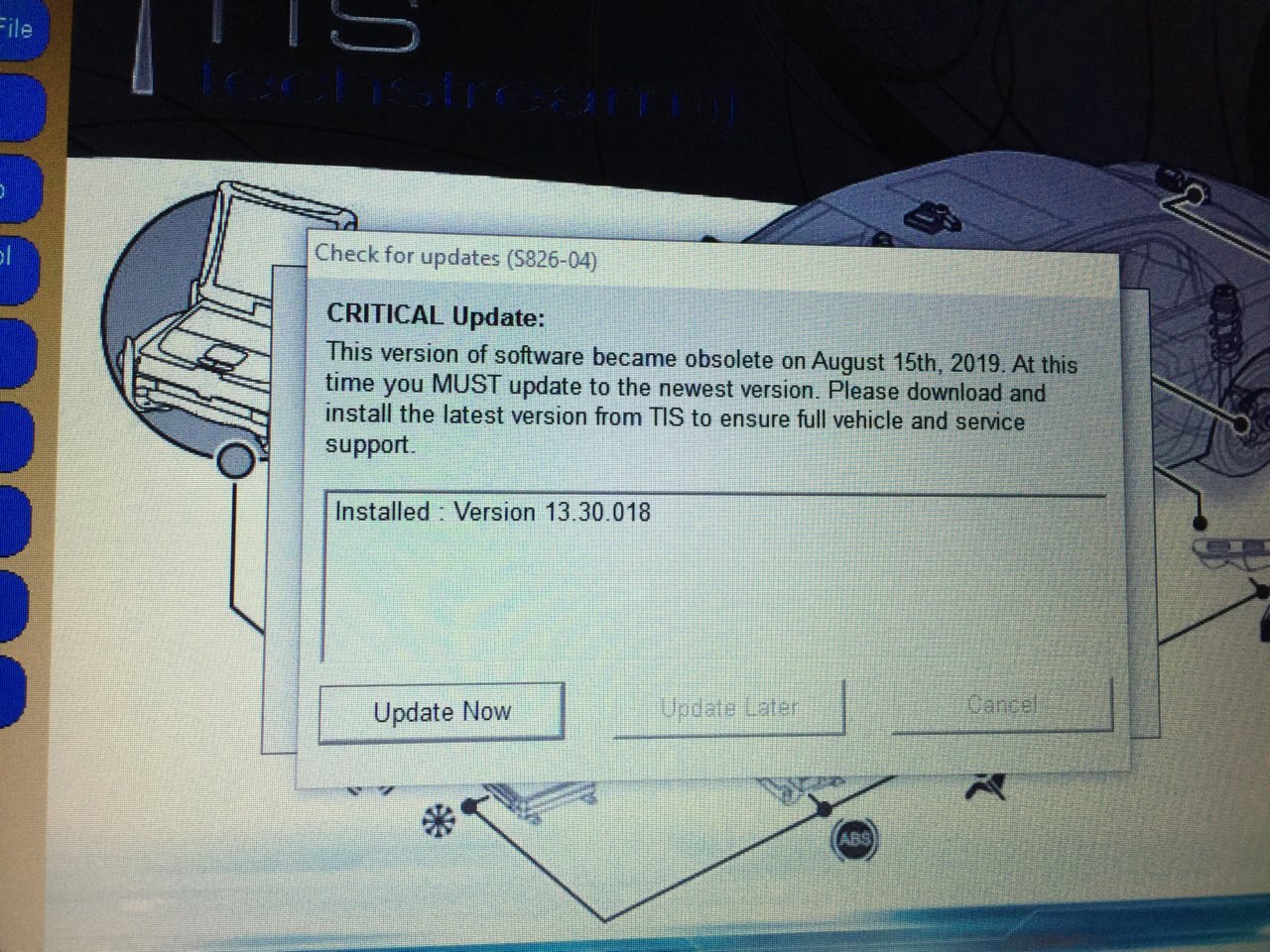

    Anybody else getting this message when they fire up TS these days? Just did it and...
    ...even restarted a few times
    @lapoltba

    Disconnect from the internet and open again. It will complain that it can't phone home but then let you run the software anyway.

    You da man. Worked just fine
