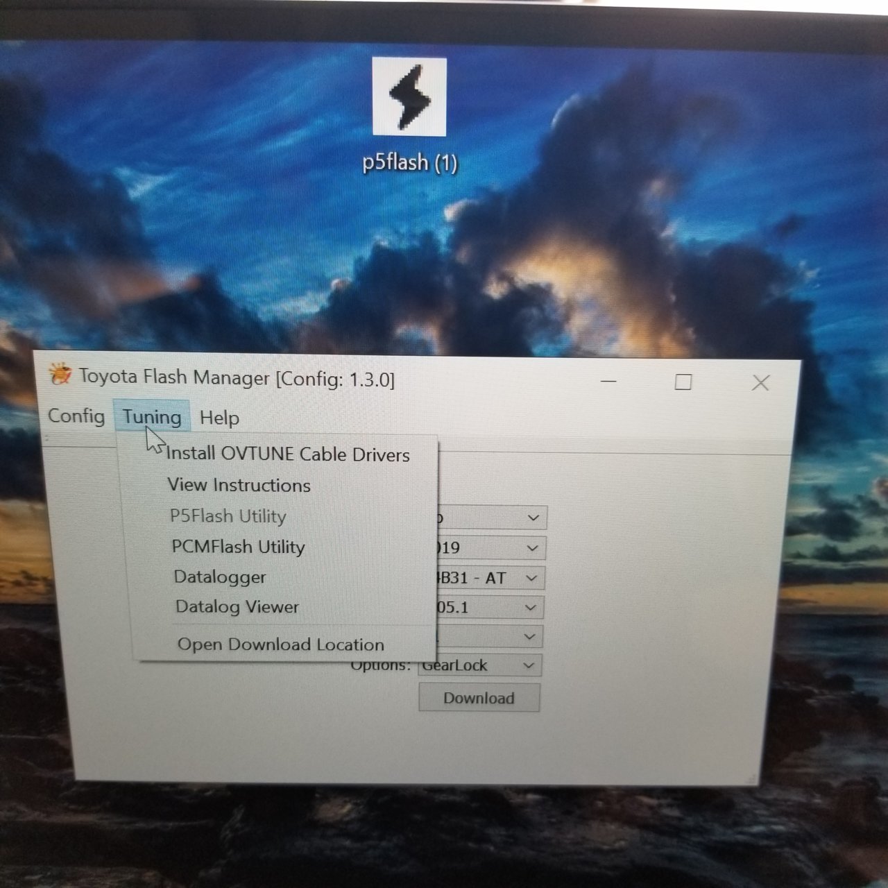

    having issues :(
    cant figure out what is wrong with this thing.
    I cannot get the p5 flash utility to highlight, so I tried downloading p5 flash separately, when I try to load a tune it gives me an error saying corrupt file etc.
    I'm about ready to take a club to my laptop and car dash hahahaha!!

    "HELP" drop down and update all?
  4. Sep 19, 2019 at 1:16 PM
    conceptmachine
    conceptmachine Well-Known Member
    Aug 31, 2019
    #303866
    67
    Jim
    2019 White Tacoma TRD Pro
    "HELP" drop down and update all?[/QUOTE]
    Thanks for the info. I did that prior and it does enable it, but when I hit the p5 flash, bottom of the dialog box it just flashes ready.... but doesn't open up the flash manager.

    Thanks for the info. I did that prior and it does enable it, but when I hit the p5 flash, bottom of the dialog box it just flashes ready.... but doesn't open up the flash manager.[/QUOTE]
    If your truck is 2017 you need to choose the year and NOT P5 but PCM. Plus you have to have the 04B04 ECU? Do you have a "Dongle"? Never mind was looking at wrong screen!

    OVTuned, decatted dump tubes
    No you don't, the dongle was either black or purple, you have the newer Tatrix cable.
    Did you install the cable drivers?

    GTS Dobinson's lift, 33"-Wildpeak Atw3-18x9 -6 Offset ,265/70/18 tires, Raceline Assault wheels, Backflip G2 bed cover, Magnaflow exhaust, Pro tail lights, Pro fog lights, Pro grille, Raptor grille lights, Predator side steps, RedLine Hood Struts, Toyota bedmat, tinted windows, Retrofitted-BHLM-Amber Halo-Amber DRL-HID headlights, LED Highbeams, LED Hood Scoop lightbar, LED hidden bumper lightbar, LED under hood light, LED Bed lights, LED license plate lights, Tacoma tailgate 3d letters, Tacoma glovebox 3D letters, removed air dam, Custom TRD Sport emblems, Pro Shift Knob with Meso ECT Stealth button, Meso LED dome and map lights, Meso V3 smoked mirror turn signals, Meso Stage 2 Tail lights, Meso Mirror Puddle lights, Meso KC-5 Brake/Cargo light, Meso center console bucket with OG lid, Tailgate PNP kit, Garage door opener button in overhead console, Meso Minimalist keyfobs, Matte black Pro hood decal, KTJO4x4 Led door handle LED lights, Pioneer 6x9 3 way front speakers, Rockford Fosgate 6.75' rear speakers, TacoTunes tweeters, AJT black vent rings, JDM Gas cap cover.
    If P5flash is grey/dithered, turn off antivirus, windows defender, anti-malware, etc. That’s probably what’s doing it.
    Got it in there. For some reason, even though I restarted my computer, I went into task manager and ended the task and then the p5 flash utility and the dialog box came up. So, there was a task running, but couldn't see it. Funny how it still ran when I shut it down and restarted. Anyway, thanks for the help. I loaded the a 1.05.1 91 octane gearlock. Went to back out of my garage and it launched it. Hopefully it doesn't take too long before the tune learns thats not what I want :) haha. I'm looking for a smooth throttle response off the line.
