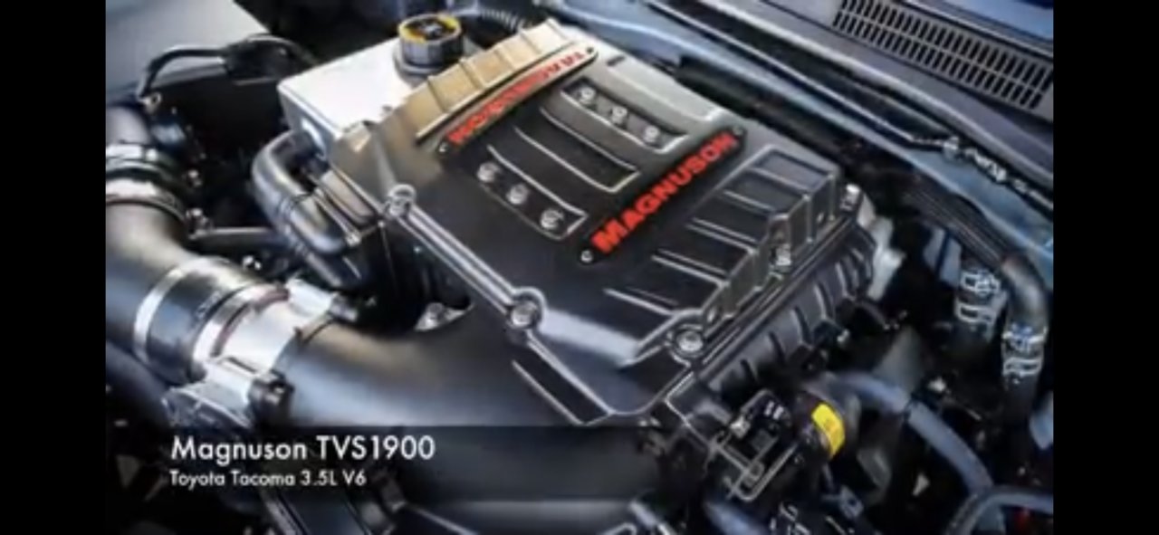

    candy from a competitor ???
    will you offer a tune for this beast? I’m sure you could squeeze a lil more out of her...?
