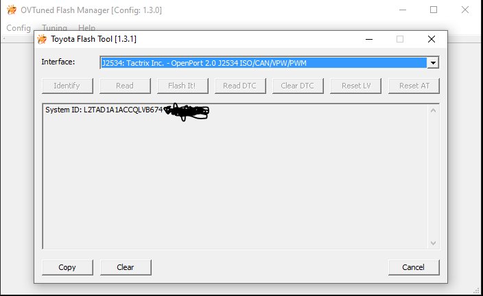

    I’ve tried both versions that I can find. I’m using x64, don’t know if it matters and yes I have downloaded the drivers from the drop down.
    I’ll take another look in the morning.

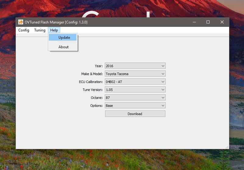

    Just to reiterate, the User is required to perform a HELP - UPDATE (as shown in the pic below, screenshot is from my FM) before trying to flash a new tune. In my experience, this is typically why the Flash It! button is greyed out. It should unlock after performing Help - Update.

    Yup, and you are 1.3 not 1.3.3. I had to update to get all the 2.0 goodness for the MT downloads.not sure why 1.3 is newer then 1.3.3 but it is.

    I never as I was afraid to lose it. Download the latest and you will have 1.03 FM and the datalogger as well. I just put 1.3.3 one off to the side in a folder after.

    Update from Mats instructions on his web page, just like you were virgin.after download, all the drivers and extra stuff is already done as you are already registered.

    So I just uninstalled and reinstalled everything and still get the same issue. Does this seem to be a driver issue? It doesn't seem to detect the truck?

    Truck is off and in ignition mode right?
  19. Apr 11, 2020 at 11:23 AM
    StormTroop425
    StormTroop425 Well-Known Member
    Feb 27, 2020
    #320520
    200
    North Bend, WA
    2020 Army Green TRD Pro
    Correct. Two presses on the ignition button without foot on brake?
    also, I have installed the drivers from the drop down menu.
