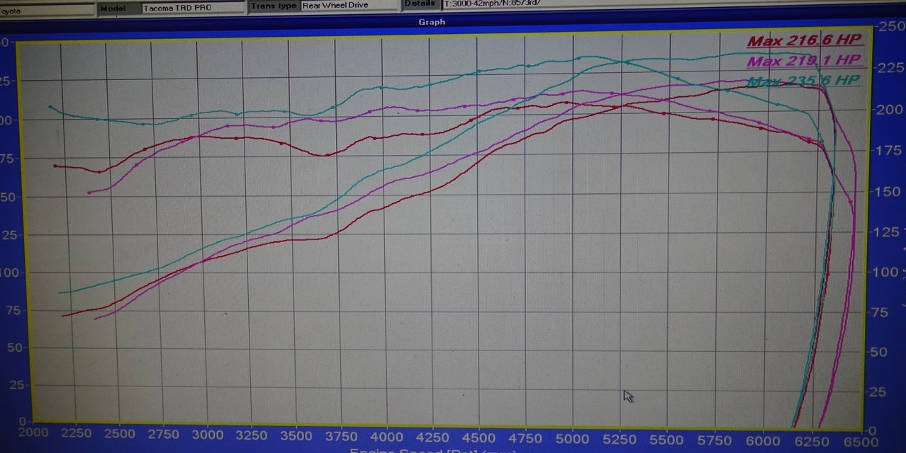

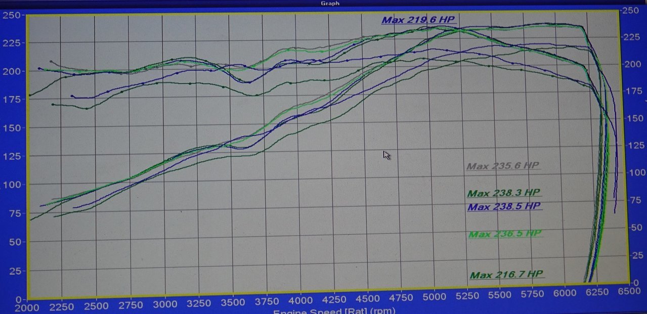

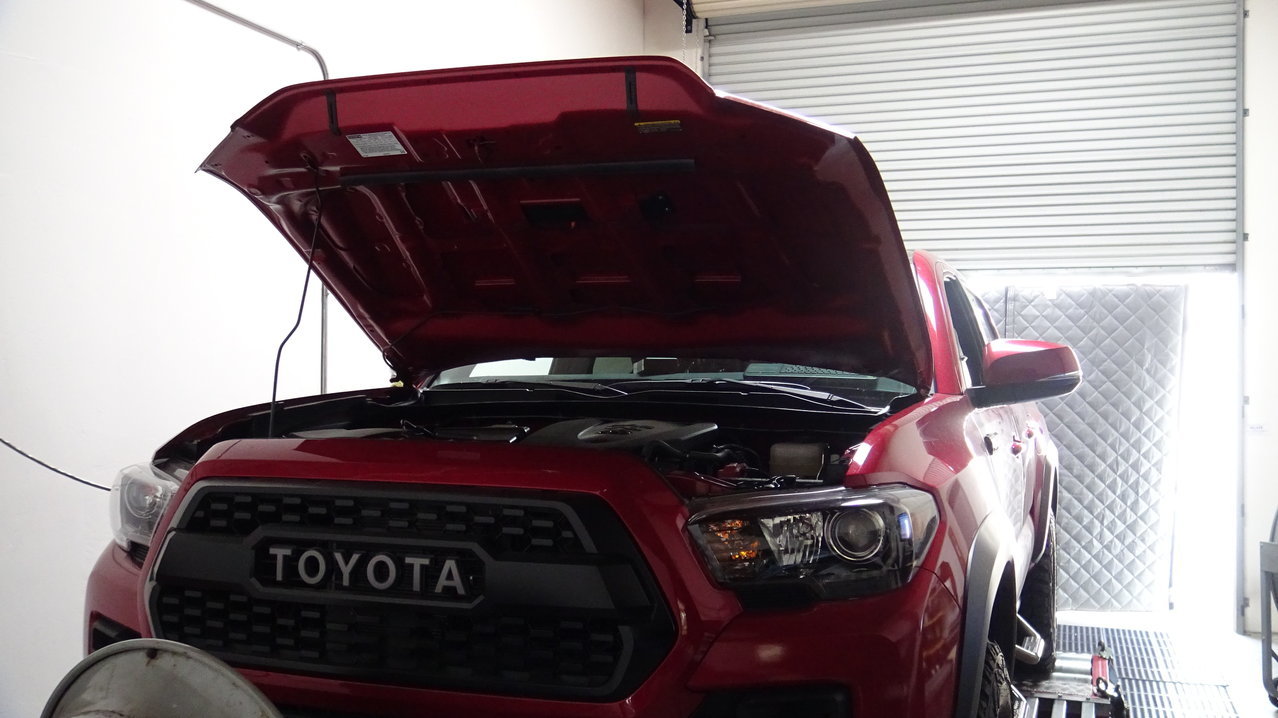

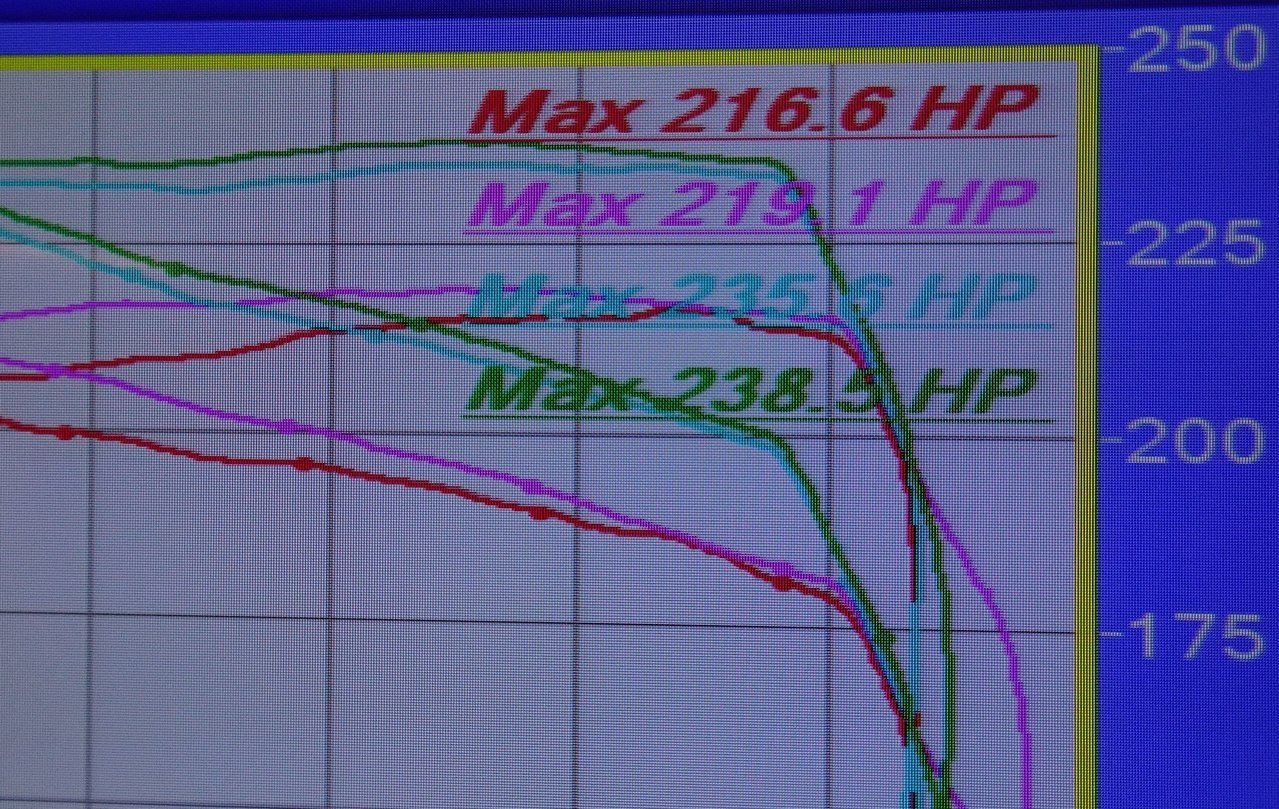

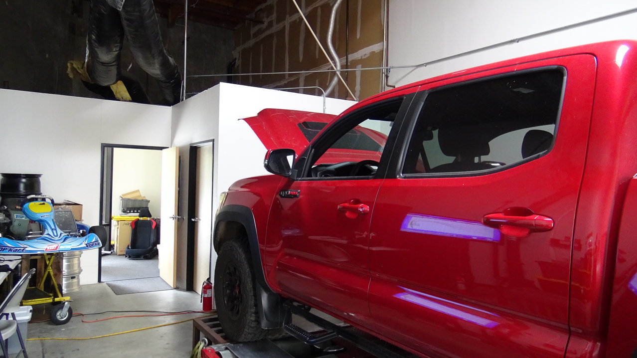

    2GR - FKS Tacoma Automatic Transmission 1.03 Calibration
    some changes include:
    Torque and Throttle control
    Torque management control
    Changes to ECT based controls
    Throttle calibration update
    Complete ignition calibration
    and a very long list of other things
    Test Truck:
    2017 Tacoma 3.5L AT TRD Pro
    Shell 91 Octane E10
    Stock intake
    Stock TRD Option Exhaust
    Pro Comp larger tires
    Pictures:
    The Results:
    Stock Flash
    1.02 Calibration (without ignition)
    1.03 Calibration
    Peak results 238whp

    So we have 200hp at 2k RPM instead of 75?? :eek:
    Edit: nope I just got so excited I couldn't read :annoyed:

    10% gain on a naturally aspirated engine from just a flash? Sweet Jesus...

    And about a 15hp bump at 2250 thru 2500 rpm!!

    @OVTune Any changes in the torque numbers?
    MOC221_ likes this.

    I did as much as I could to create a nice flat torque curve, and hold torque as long as possible. A few tests I was able to create a nice flat torque curve except it was in general lower everywhere though.
    A lot of time today perfecting the ignition, changes to injection firing angle, and an extremely long list of other things.
    I expect to release at the end of this week. More power was gained than expected so I have to tweak the maps in the transmission to firm up the shifting. Since the expected torque is lower than actual the transmission is a little sloppy on shifts when it's cold, because the truck no longer has the dead fish feeling when cold, not limiting on cold engine. I will have this fixed tomorrow.
    The difference now in how the truck responds and accelerates is phenomenal. The response to what the driver demands is immediate and crisp.

    @OVTune all those dyno number done on 91 Octane? if yes, what should we expect from 87?

    Top Curves are HP and Bottom are Torque correct?

    238whp is a good bump from where it originally was. The old chart showed it around 221-222.
    ebbs15, MOC221_ and MESO like this.

    Bottom hp top torque. (Starting from the left)
    I think this truck will do 250+whp with full exhaust (that's next :) )
    Because of the update needed to the transmission, Manual Transmission owners will receive files first
