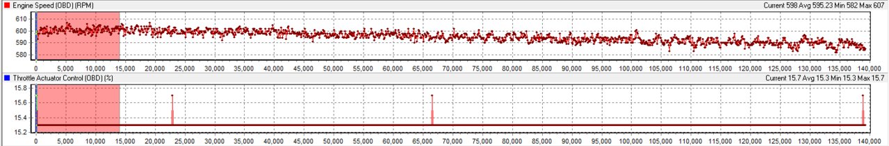

    OVTune
    OVTune [OP] Well-Known Member
    Mar 27, 2017
    #214557
    8,112
    OVTune
    Majority of our customers actually have larger than stock tires...
    Idle RPM is now within +/- 5 rpm.
    Will confirm with trucks that have the issue.
    I appreciate everyone being patient.

    OVTune
    Is that with AC on?

  5. Dec 22, 2018 at 11:32 AM
    OVTune
    Mar 27, 2017
    #214557
    8,112
    OVTune
    in D mode
    A/C on test
    heat on full blast test
    etc,
    also tested in 4H/4L.
