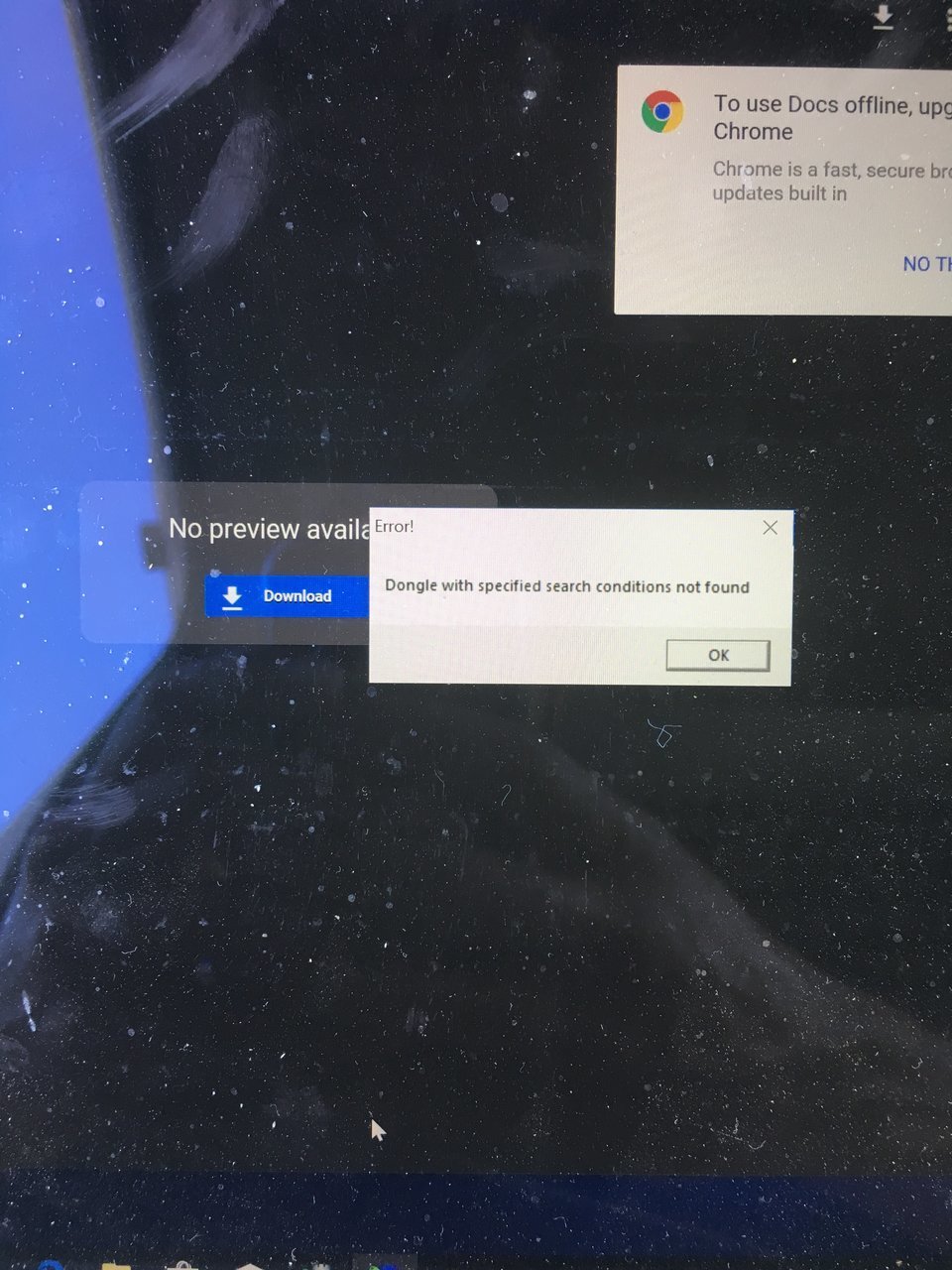

    I’m hving a hell of a time getting through this process. I’ve got windows 10 installed. When I go to run GrdTRU.exe it says “dongle with specified conditions not found”. Any thoughts?
    Additional info:
    I’ve downloaded tactrix, the dongle driver and pcmflash

    Wow! Thanks for your quick response Matt. I did that though. After I downloaded the driver, I plugged in the USB and it says “USB dongle is not accessible (0). Please check if it is connected and restart application. Application version: 1.1.83”

    I had a similar same issue. Everything worked fine setting up the dongle with GrdTRU.exe, but when I ran pcmflash I got the same error message as you. I tried everything I could think of, but unfortunately in the end I had to use a different computer.

    Well, it tough to say what exactly the problem is because everything worked fine when running the GrdTRU.exe setup. I also ran the Guardant diagnostic utility and it was able to see the dongle and everything. The only thing that couldn't see it was pcmflash. That's where I saw the error you mentioned. When I ran it on my wife's laptop, it worked fine, so I stopped trying to solve the problem on my laptop.
    I have seen others report success with using a USB splitter or hub or even simply trying different USB ports. My laptop only has 2 USB ports and it didn't work with either of them. I don't have a USB splitter or hub so I didn't try those options, but they're pretty cheap so it would be worth trying before giving up. I may do this as well just to see if I can get it working on my laptop. Hope it works for you.
    Also, make sure Windows Defender is turned off before downloading and running pcmflash. It turns itself back on eventually and will delete pcmflash for you.

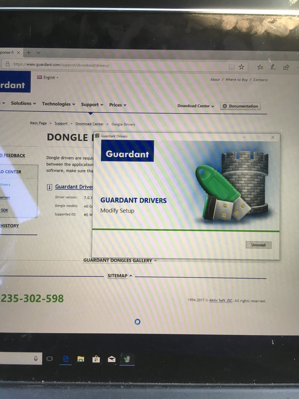

    Did you install the Guardant drivers (GrdDrivers.exe)? That has to be done before anything else. Once that is done, you plug in the dongle and run the GrdTRU.exe file and send some codes back and forth to OVTune. After that's done, you open pcmflash. That's where I got the error message.
    It sounds like the drivers may not have installed correctly (or maybe not at all) for you. Make sure Windows Defender is off and try running the GrdDrivers.exe file again to make sure the drivers are installed. If they are already installed, try uninstalling and reinstalling just to be sure they're not screwed up somehow. As for the diagnostic utility, it can be found by clicking on "Guardant drivers" in the Windows Control Panel. When that opens, there is a button to run diagnostics.

    I've had the best luck with USB related drivers by booting Windows 10 into Advanced Mode to allow unsigned drivers. Follow the steps under section number one of the site linked below. If you're a bit more tech savvy, you can try the methods shown in section two, or three, but section one is the easiest and safest. Unplugging all other USB devices also helps.
    You'll boot Windows 10 into Advanced Mode and then install all of the tune related software. Note: The next time you reboot, Win10 will revert back to disallowing unsigned drivers.
    https://www.maketecheasier.com/install-unsigned-drivers-windows10/

    I have two USB ports as well. I’ve tried them both. My intuition tells me that I’m not downloading the drivers right. Is there a way to confirm that they are downloaded and are in the right place? In the instructions, it says that once the guardant driver is installed, it should show up on my desktop. That never happened for me. I wasn’t sure if I did it right or not so I clicked the download button again and the image of the castle shows up. The image is about 2”x2” (not an icon). On the image, the only button there says “uninstall”. That leads me to believe I did it right, but it’s not on my desktop.

    Here’s where I’m at:
    From the instructions page, I click the link where it says “Guardant software protection drivers”. It takes me to a page that gives me the option to download. I plugged the purple usb into my computer and hit download. When I do that, an image comes up with a button that says uninstall. Without hitting that button, I went back to the instructions page and clicked the link user “Guardant software license installer”. It takes me to a page that says “no preview available” and gives me an option to download. Then I get an error message that says “Dongle with specified search conditions not found”.

    Here’s the error message

    Ha!!!!! I think I did it!!!! Holy s^%t that was easy.... NOT! Lol. We’ll see. Thanks to everyone that helped me. I really appreciate you guys taking the time with me. The funny thing is that I’m a youngster (34) and I should be better at these things, but I’m such a dummy
