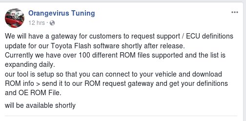

    @OVTune does the below apply to Tacoma's as well? I know our trucks are a different breed ECU wise...
    MOC221_ likes this.

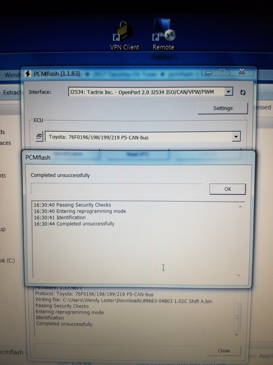

    I was hoping to tune truck tonight. I picked 1.02a and followed prompts and this is what i get...now truck has check engine light and traction control light and brake override malfunction contact dealer on dash. Any help would be appreciated.

    #8156

    2016 Super White Tacoma TRD Sport 4X4 DCSB
    I'd say try flashing again. But you may wanna wait for Mat or someone who knows more than I do to answer that.

    DO NOT TURN YOUR TRUCK OFF!!! Likely can click OK and it will ask you if you want to retry - this has happened to me randomly a couple of times and it freaked me out initially but the retry always works. Key is DO NOT TURN YOUR TRUCK OFF

    Agreed. It only got 4 seconds into reprogramming mode and quit. Lost comms with the truck?
