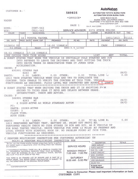

    so my experience with this issue has been a tad more positive than others that ive read. walked in the dealership this morning and explained my R to D lag and awkward shifting of gears. spoke with service manager and we agreed to leave my truck until the next morning, unless they can duplicate the issue. he wanted me to be there to show them personally so that we're all on the same page and i agreed. HOWEVER, i mentioned that my buddy had the same issue and his dealership found that the ATF was almost a whole quart low. the service manager calls over the master tech and my service advisor and had them inspect the ATF first, then try to replicate the issue. he suspected that if the ATF is indeed low, it would act as such.
    long story short, my truck was 0.5 quart under. they couldnt replicate the issues i had when i brought it in that morning. it seems better on my drive home. ill have to check it out tomorrow morning and give an update on the cold start R to D issue. if youre in the socal area, i took mine to Buena Park Toyota, theyre part of the AutoNation dealerships.
