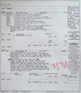

    Brought my Tacoma into Toyota of Naperville today, for its 5k mile service.
    I explained my concern about the Automatic Transmission fluid level, and asked that they check it. I gave them a written explanation of everything I said, as well as a hard copy of the procedure (that I found here, of course).
    They had the truck for a total of 9 hrs, and found the fluid to be 1 quart low.
    They also topped off the Transfer Case and Differentials, and they changed the oil and filter (without me asking).
    I'm very happy with the service I received from my dealer, though it is still annoying that Toyota let this situation develop.
    Many thanks to everyone on this forum for alerting me. I did vote on the Tech Chat thread.
    Frank
