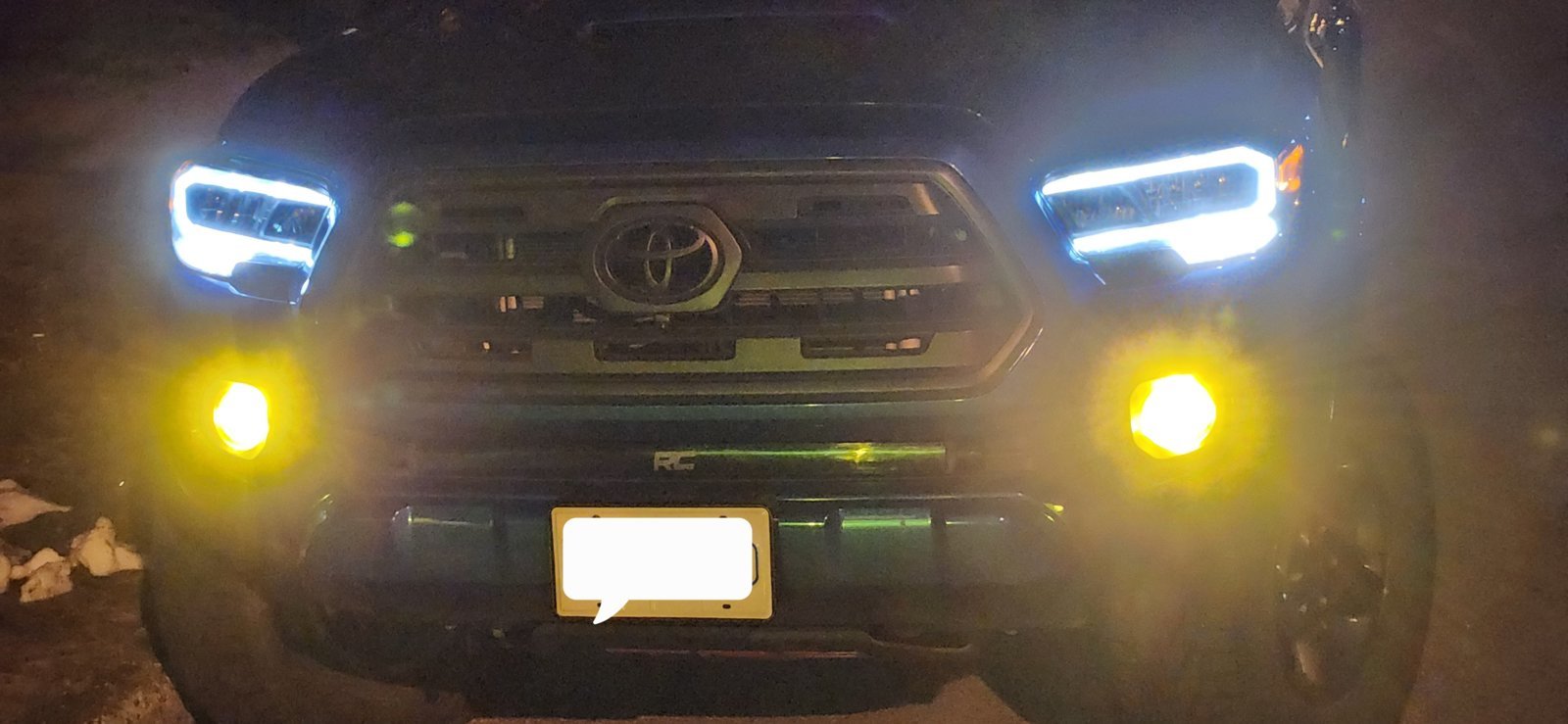

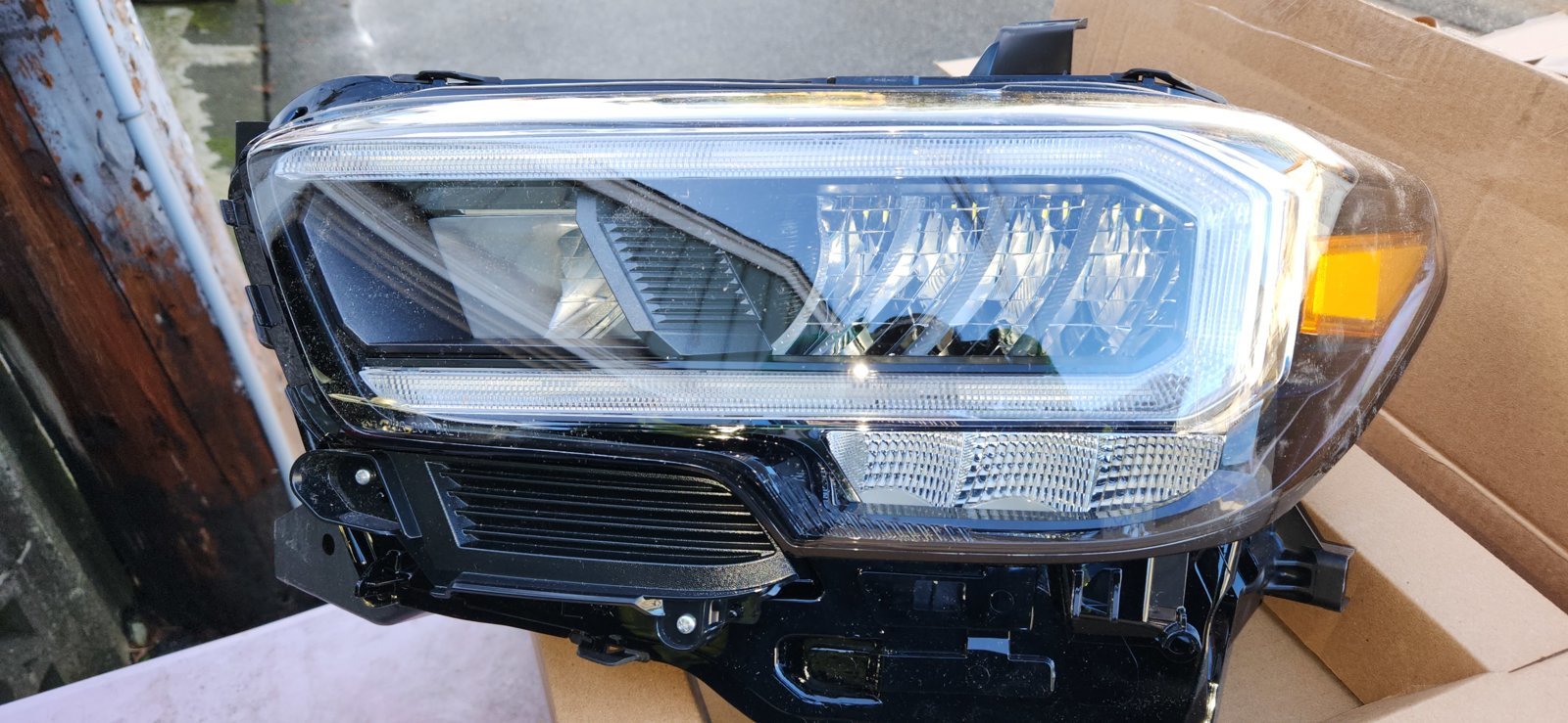

    I replaced my halogen assemblies with factory LED assemblies. They are a huge improvement and in my opinion the single best modification I have ever done. I definitely recommend them. You can also improve forward visibility with a decent set of fog lamps. I chose Diode Dynamics Elites in Amber.
    I have also installed a 30" Rough Country LED bar in the front bumper for off-road duty.
