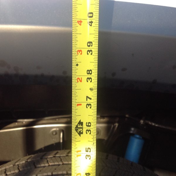

    Yes, small height increase. This is how my Taco sits presently. FYI: I also have 18" wheels so that might add to the height. 37 9/16 from the floor/ground to the bottom of the wheel well.

    Great thanks. Did you notice any difference in rear ride quality? Doubt it but just double checking

    No discernible change to me.
