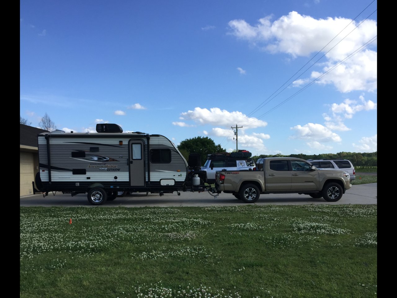

    Hello. I have a Starcraft autumn ridge mini 18bh. The camper weight is around 4000lbs and useing a weight distribution hitch with the P3 brake controller.
