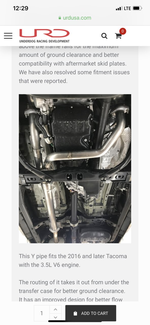

    From URD’s website for 2017 Taco this pic doesn’t show a heat shield. I’ve found other pics on the internet that also do not have any heat shield.

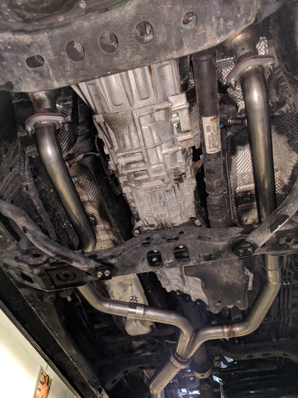

    [TTACH=full]3085583[/ATTACH] URD1.jpg
    here is a pic of the full exhuast with equal lengh y pipe installed

    Is that a URD? Long bed or short?

    urd spec u full exhuast and fits both short and long beds

    Sweet... I was looking at this. Any video and/or thoughts on exhaust note/performance/fit? Also do you have stock down tubes (manifolds)? Thanks.
    edit: nm, I see the stock tubes...

    Bringing a post back up. Where did you get the equal length Y pipe? Custom made?
    Been looking at just doing the OR urd Y pipe with stock exhaust. Already running RCI skids minus the trannsfer case one due to stock Y pipe still installed.
    Any other Y pipe options out there? 589 seems steep but realize $$ are going up on this type of stuff.

    think thats urd spec u exhaust. equal length y pipe plus muffler i think. doesn't work with certain skids. at least but without some modification. not sure about rci.

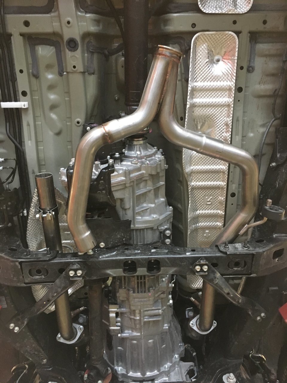

    I run aFe's Y-Pipe, which has been better than my experience with URD's. It may be because URD is a bigger piping, it had a raspy metallic sound around 3-4k rpm.
    It is paired with a Borla S Type muffler. I think it sounds great down low and high up. Just the mid range a little rasp depending on load and gear it is in (usually 2nd/3rd gear)
